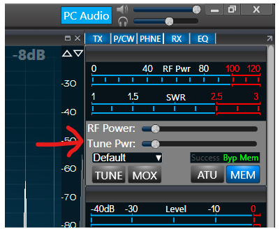

RE your first point, you can just turn up the tune power in Smart SDR. Move the slider to give more power?
Or you could create a couple of TX profiles, one with Tune at 10W and one with it at 80W and just switch between them, if you don't want to move the slider each time.
