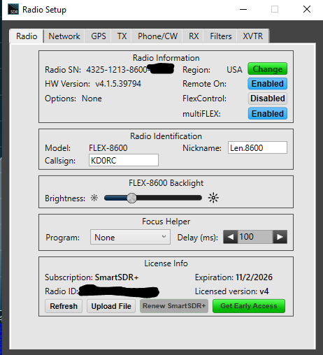

    Hi Steve,
    Can you send a screenshot of your Radio tab in Radio Setup? Here is mine for comparison:
  • Steve_AJ6TL
    Steve_AJ6TL Member ✭✭
  • Flexed
    Flexed Member ✭✭
    If clicking “refresh” doesn’t resolve the issue, please open a ticket. Is this the only Flex radio you own?
