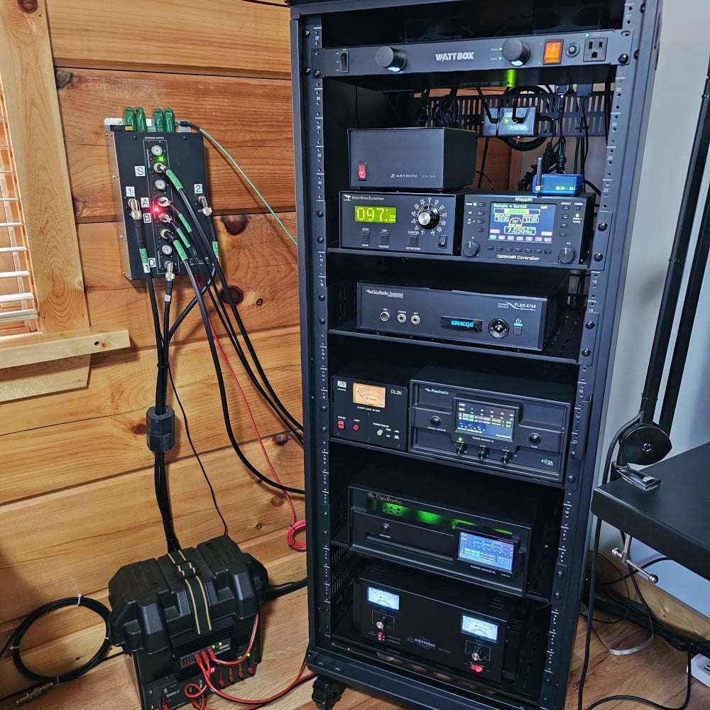

My 6700 been running 3.10.15 but struggles to run 8 Slices with PGXL SO2R tuner and AG.
I've decided to go back in time and find a Version of Smart SDR that works all 8 Slices without crashing.
The crashes started about 1 year ago so maybe Smart SDR 3.7.4 will work.
If anyone has a version working the 8 Slices successfully please chime in.

    I am running SliceMaster 10.g however it occurs even when nothing is running only Smart SDR 3,10.15
    I am running this from an imported Profile that I have used for many years.
    Tim thinks the 6700 is at it's resource limit. Running all of 403a add ons.
    I have to wonder if the problem is not in how Smart SDR has grown now included Tuner and Amp.
    I know I used the same hardware with no issues and for me the software add ins are not needed can just run the PGXL and Tuner + AG Apps on all our computers seperatly from Smart SDR.
    The other interesting thing is the problem will also occur if I run a single Slice on my SSTV profile at times.
    So maybe it has something to do with my imported Profiles.
    Any Thoughts
    Ian
    SliceMaster 10.g will consume network resources on me. I have confirmed that.
