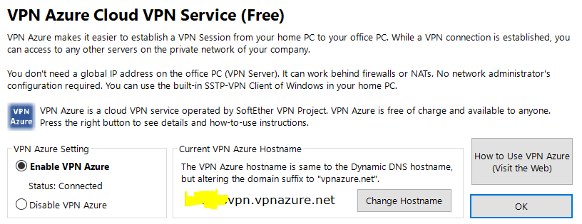

I had used SoftEther on and off for a long time, but it has been a couple years since I used it and wouldn't you know it, it would not connect remotely through my cellphone hotspot but it would connect when on the local wifi LAN so today I decided to get to the source of this problem.
I just posted my solution in another post:
I have identified the problem why my SoftEther no longer could connect remotely. I confirmed I am behind both CG-NAT and double NAT.
After some research I found that it was suggested to use VPN Azure.
- If the firewall is more restricted and the NAT Traversal of SoftEther VPN doesn't work correctly, instead use VPN Azure to **** such a firewall.
- a works around strick firewalls
- gets through double NAT etc.
To fix this you have to enable VPN Azure in the SoftEther VPN Server Manager, this will take your Dynamic DNS hostname such as mystationvpn.softether.net and make a new one mystationvpn.vpnazure.net you then would need to copy the new Host Name and replace it in your SoftEther Client Manager.
To do this, open up SoftEther VPN Server Manager and then Manage VPN Server by clicking CONNECT. You should already have a Dynamic DNS Setting from the original server setup. You can enable VPN Azure by going to VPN Azure Setting button, and selecting Enable VPN Azure radio-button it will take a short bit for the status to say: Status: Connected
Then copy the new hostname and edit your VPN Client Manager user on the computer you use to remotely login. Open up the VPN Client Manager and right click on the user, select Properties. You will see xxxxx.softether.net in the Host Name field. Replace this with the hostname you copied (xxxxx.vpnazure.net), click OK.
That's it !
