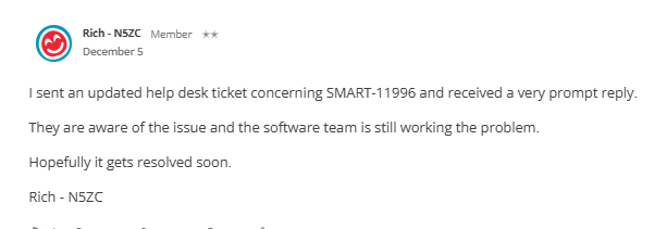

RE the CW return to receive issue:
Don't want to cross threads but here is a comment from 5 Dec with a SMART reference - has this been resolved, didn't see it on the change log for 4.1.3 or 4.1.5?
This is from this thread on here
https://community.flexradio.com/discussion/8032561/version-4-cw-return-to-receive-issue
