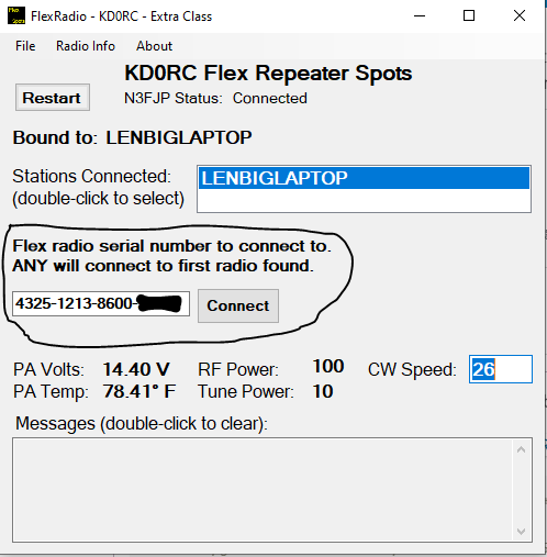

    FlexRepeaterSpots V1.13 is now available on GitHub:
    https://github.com/KD0RC/FlexRepeaterSpots/releases/tag/FlexRepeaterSpots_V1.13
    // V1.13
    // Upgraded so it will compile under Visual Studio 2022.
    // Upgraded FlexLib to V 4.x.
    // V1.12 (not released separately)
    // Fixed bug where slice index got lost causing app to crash.
    // Added ability to select which radio to connect to.
    New this time is the ability to select the radio that you want, or just specify ANY and it will connect to the first radio it finds. If you have multiple radios on the same LAN, this new feature is indispensable. If not, you can leave it at the default of "ANY".
