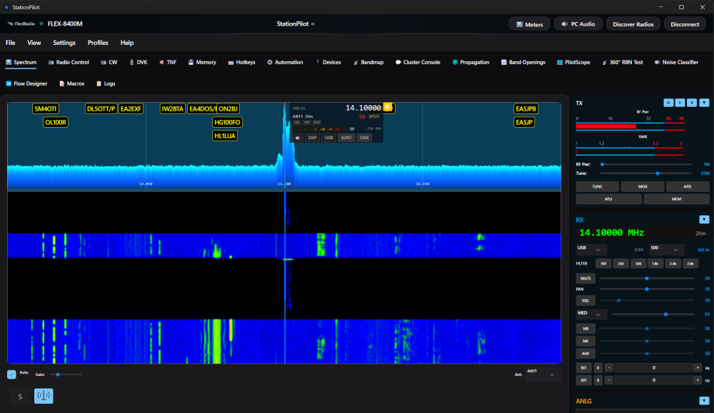

    Running companion with SmartSDR only functions as spot aggregator, hotkeys, hamlib, automations etc not spectrum and waterfall.
    Standalone it is full functional panadapter with TX/RX

    @serialcoder This is what I am seeing now. As soon as I connect to my Flex with StationPilot v1.0.6 the Flex's spetrum display freezes. The waterfall in SmartSDR slows down a bit. I have yet to see a panadapter in stationpilot.
  • serialcoder
    serialcoder Member ✭✭
    edited December 2025
    @ka9ees if you close smartsdr you will get a panadapter and tx ability. Are you on 4.1.3 on the radio?

    @serialcoder It works! Except… I have no option for a direct mic connection to the Flex. Without that the program is useless. Tuning is clunky. Took me forever to get the display to zero, on whatever frequency I was operating. The waterfall is way too fast. Need control for that. It's a nice looking prorgam, but as it's devoloping, it still needs work. Keep going Stephane!
  • serialcoder
    @ka9ees glad you finally saw it running. you’re right it is hard coded to pc mic, i’ll put the option for mic like in smartsdr in next release. also will look at a slider to slow down the waterfall. the tuning is a bit finicky at the moment…we’ll get there
