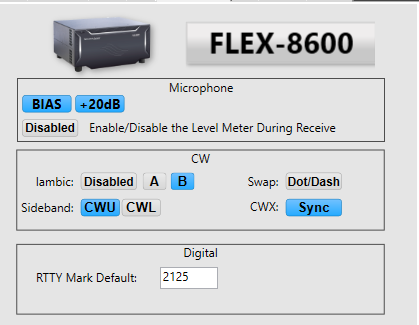

No new CW settings. You might try exporting your profiles, then do a factory reset. If that doesn't help, post a screenshot of SmartSDR here so that we can see your settings.

I've seen the same. Note that you've got Iambic disabled (me too). If I enable Iambic, and hit the straight key, it'll make dits (so it's getting the input - just not acting on it when not Iambic). Then for some unknown reason, upon switching back to Iambic disabled it then seems to work. Sometimes I'd have to hit the key a few times to 'wake it up'… Give that a whirl and see how it plays.
@WA5YOM I use a bug too, and have the same settings that you do… and for me, it works as it always has. I get dits and dahs as always, from the Vibroplex bug.
I know it's not helpful to you 😞 but it's a data-point that does rule out the software…
