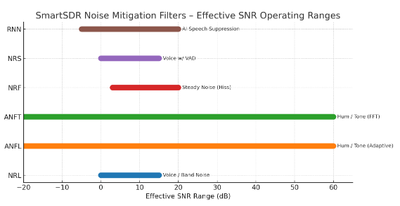

Yes, RNN has to be tuned to the voice since it is designed and taught for the human voice. It also has a finite SNR range.
