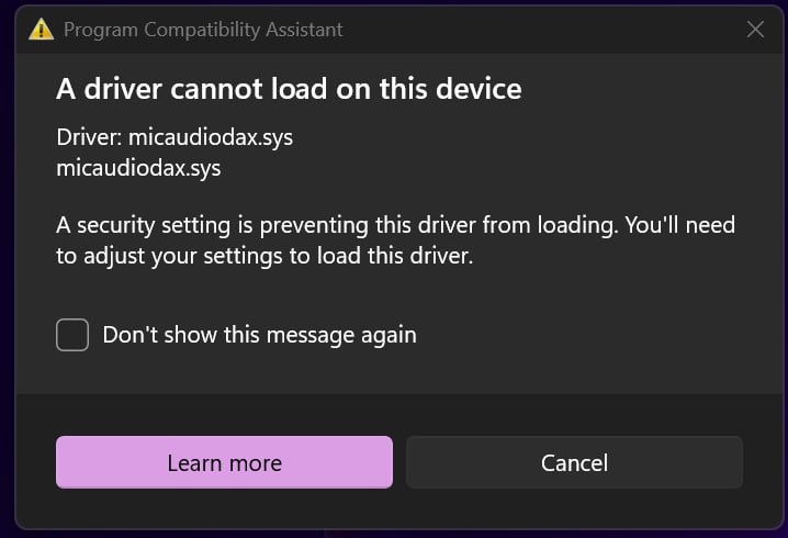

    Hey Len, i downloaded 4.1.3 and did the install. I got this error:
    It was my anti virus and VPN from Aura that caused it. I turned them off, re-installed and it went through just fine!

    You need to turn off Memory Integrity in the core isolation settings

    So this must be a known issue with that driver. Is there a fix in the works for this driver? I went through the MS website about turning off Memory Integrity and this is what it says:
    Warning:  Turning off Memory Integrity on a Secured-core PC takes the device out of a Secured-core state. If you choose to continue using your device without addressing the driver problem, you might discover that the functionality the driver supports does not work any longer, which could have consequences ranging from negligible to severe.
    Thoughts!

    Turned mine off . . . Did install and turned back on . . . No issues here

    ok, so it will not let me turn it back on because of the compatibility issue, as long as it exists it will not allow me to turn memory integrity back on and it lists all the Flex drivers (8 of them) as incompatible.

    Looks like I should have turned that off before I did the 4.1.3 install. I didn't know there was an issue. Do I have to un-install then re-install 4.1.3 OR can I just re-install it without uninstalling it? Sorry for all the questions, just not as tech savvy these days and a lot has changed.

    I just re ran the installer . . . Actually I misspoke . . . It won't turn back on due to issues with the flex audio drivers

    yup, just an fyi, i went ahead and un-installed SmartSDR, re-installed it (making sure that Memory Integrity was switched off). Went back in to turn it back on and you can't. Any idea if Flex is working to correct it?
