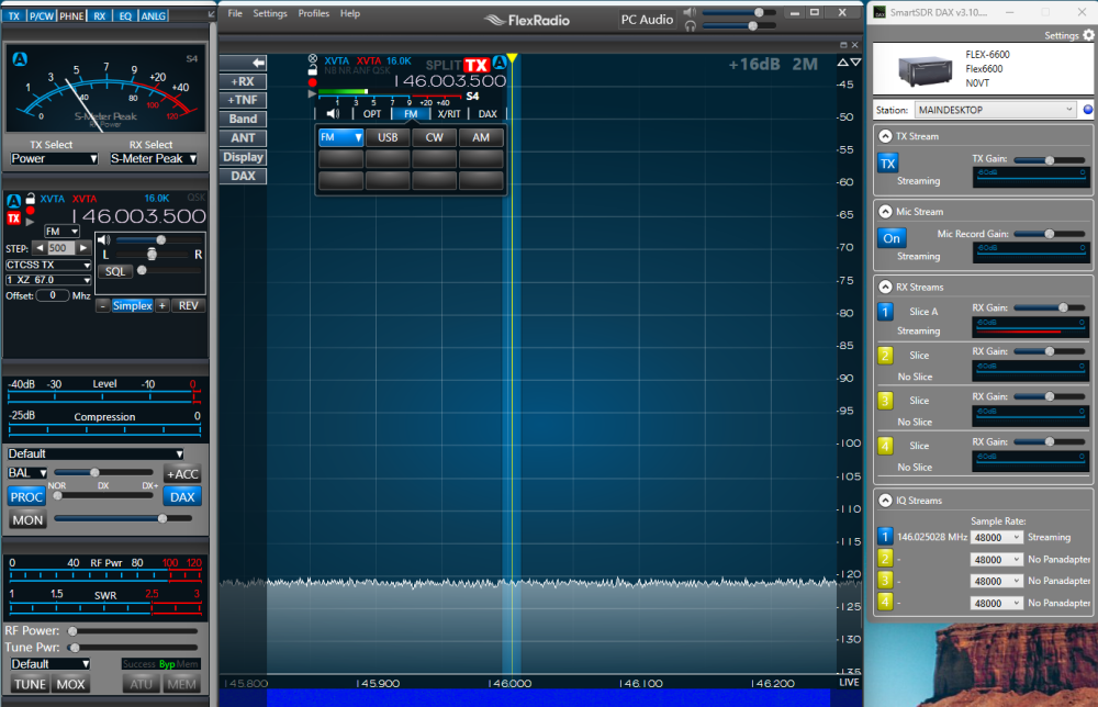

I have had a Q5 transverter for quite a while but haven't used it recently. I just got a VHF wattmeter and thought I would check things out. The problem is that I get no receive audio through my speaker.
All the settings look good.
The settings under Radio Setup/XVTR are accurate.
Audio settings on the radio are where they should be. Squelch is off, audio balance is centered L/R and both audio sliders are up.
I have plenty of audio when I switch to an HF band, so my audio amp + speaker connections to the radio are fine.
I have checked FM, CW and USB modes, no change.
Transmit power output is fine—I get deflection on the external power meter when speaking— so it isn't a connection/cabling problem. I simply don't have any receive audio when using the transverter.
Please take a look at my settings and tell me if you see what I've missed. Thanks.

I found out that it had something to do with the global profile I was using. Changed it to a different one and audio came back.
Turn TX DX off and give it a try. That will **** your BAL Mic connection.
