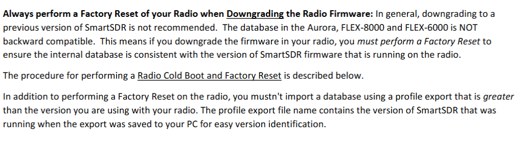

After downgrading, you need to do a factory reset.
Hello Len, thanks very much for this hint, this helped me out this issue!

Hi Asher, you might want to try a factory reset. If that doesn't help, submit a help desk ticket.

(2) you might want to try a factory reset

Please open a support ticket. there is no reason that v4 should be causing this issue. If you downgraded, reset the radio and rebooted the radio and still had the same issue, then it is something that needs to be looked into.

Does the problem still occur after resetting the radio?
Let us know.
Thanks Mike for the suggestion!
I reset the radio and so far the problem has not occurred again. In my case, the problem was intermittent so only time will tell if it has really been corrected.

Sometimes importing the v3 profiles can cause an issue. There might have been some corruption on the original v3 profile. We haven't had time to get to the bottom of it just yet.

You didn't mention you did a cold restart.
If that doesn't help you out, did you try to reset the radio? That should resolve most things.
Following helpdesk (Tim) advice I performed a comprehensive cold boot and factory reset using precise timing at steps this afternoon.
The 6600 is now working.
