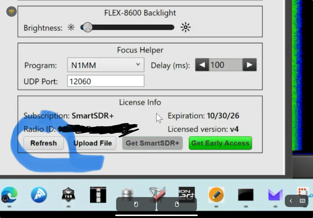

Did you click the refresh button? It’s the green button on the left.
yes, I have pressed refresh and each time the 6400 loses comm and crashes. Also, the button to the right is not greyed out like your.
