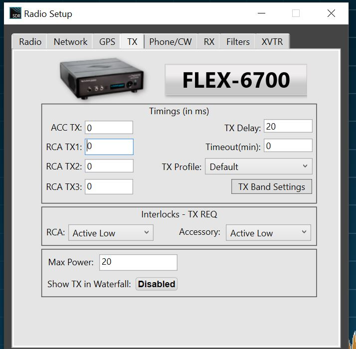

Check in the TX tab in radio set-up you have the max power set to 100. You can see here it's set to 20, if that's set to 80 for you it will mean you can only go to 80.

Has been set 100 since I have had the radio. Slider all the way up.

In the radio setup tab, the power has always been set at 100 watts. My power slider is set all the way up.
