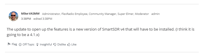

Will have to see if the 4.1.x release on 30 November will contain any fixes or just enabling the new functions that the SSDR+ users will get.
I don't believe that what happens on November 30th will be anything more than enabling the new features for SmartSDR + users. It would be nice if it was a new point release that includes fixes for several bugs introduced in version 4.0.1. ( Basic and others) A point release to fix bugs can occur at any time. New features are a different story.
Already confirmed it will be 4.1.x so it's a new version. That was as of this afternoon.
Yeah, from my understanding, the next point release can happen at any time. But, on some other post today, I read a new point / bug fix release might occur around 2 /12 - 3 weeks? from now. Speculation of course. But, the SmartSDR+ users will want bug fixes out of the gate on or before their features are turned on. Even Basic users will want bug fixes sooner rather than later. We shall see…. Dan WA1QZX
