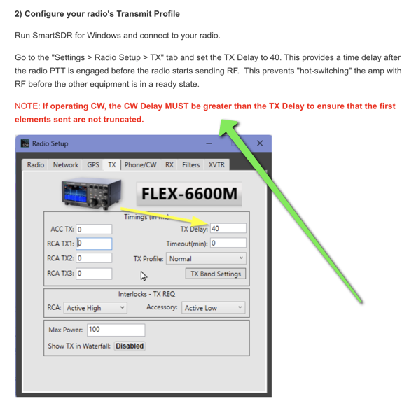

You may want to review the dream station documentation.

Can you try increased your CW Delay to about 125 and see if it goes away.
I have increased it all the way to 500 and it seems to have no effect.0

Set TX Delay to 30ms and see what happens.
73, John K1ESE
I just tried the 30ms John and hit a couple of beacons so I will see how that goes. Thank you for your help!
George NE5A0 -
Well, I don't have a dream station and am not using an amplifier with the Flex. My CW delay has always been higher than the TX delay because the TX delay has always been set to 0 until I started trying to figure out the missing dits. I have the TX delay set to 30 and the CW delay set at 225 and now I can reliably hit beacons and don't seem to be missing dits.0
