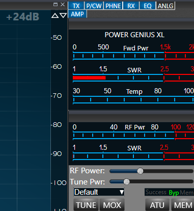

I noticed that while in receive, I have a reading on the SWR meter that flickers between nothing and 1.5. Again I'm not Transmitting
My take is that this is a V 4 glitch. Anyone else seeing this?
    Can you post a screen shot? Is this in SmartSDR or an M Panel. Is the SWR meter doing double duty as a S Meter as well?

    … and is this on the analog or digital meter (or both)?

    this is just sitting like this with an S1 showing on my S meter . Could be mimicking the S meter, but why?

    also this is not an M model

    Hmmm, I'm not sure about the interface with the Power Genius, but this does look like something do with it specfically. (e.g. the AMP tab)
    I'd suggest you open a Help Desk Ticket, as they will be very familiar with what to expect on this part of the interface.
    That is the SWR meter on the PGXL. I would reboot both the radio and the pgxl and see if you still have the issue.
