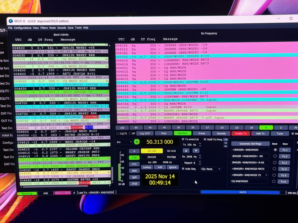

I was operating my Hawaii remote on 6 meters tonight from my PC in NJ. Worked a bunch of JA’s, and Brazil and Argentina.

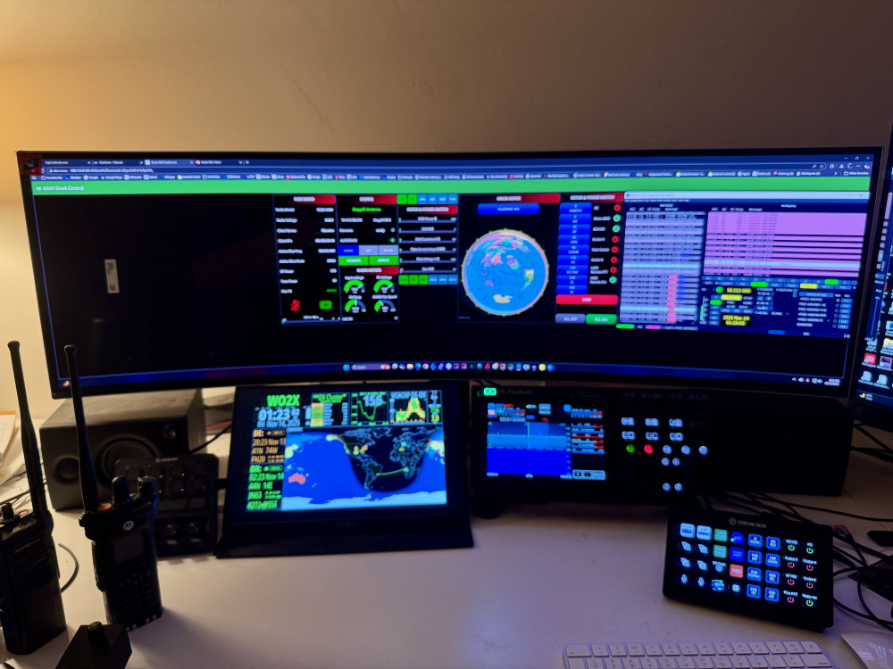

I wasn’t sure how I would like the 49” ultra wide monitor vs rework of the three32” monitors but I am really liking it. A little less vertical real estate but easier on the neck for viewing (less up and down movement). The OLED screen is bright and very clear.
The MonstIR antenna on HI station is working very well since repairs this past spring. It has two passive elements for 6 meters giving 6 elements total on 42 ft boom. I really haven’t used it for 6 meters until recently when I saw a post on the 6 meter Front Range mail reflector about openings to Hawaii this week.73 Dave wo2x

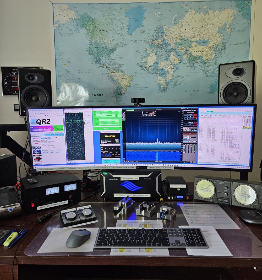

I made the same change, from 3 monitors to a single Dell 49 inch when I upgraded my PC to Win 11. It is easy to set up multiple desktop layouts and switch between them with one click. Also like it.
