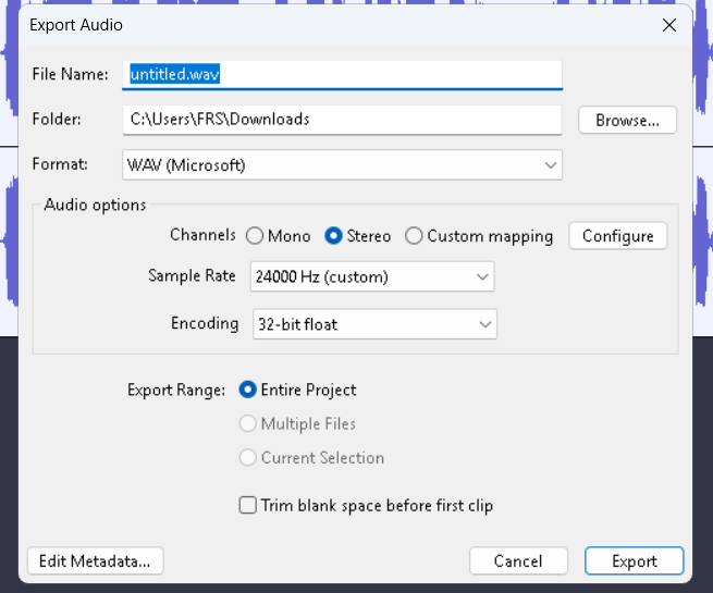

Dear Bret, making file WAV with Audacity (freeware) and convert it in stereo and frequency 24000 Hz.
Work fine.
best 73 de IZ7AUH
This is from some previous testing I did with the developer a while back.
Give it a try.
Thanks guys, I have tried one files but got the same error using your settings Mike, Continuing to test different options.
All my existing WAV files won't work with your settings Mike so it must be magic.
I Re-recorded the ones I could using SmartSDR DVK and they work fine, Looking at these files they are exactly the same format as my original files, I also checked the File permissions which are the same, The file location is on my desktop in my Flex Profiles folder so I don't think it's a permissions issue.
maybe they get this fixed in a feature release
If the 24000 doesn't work, open a support ticket please so it gets tracked.
