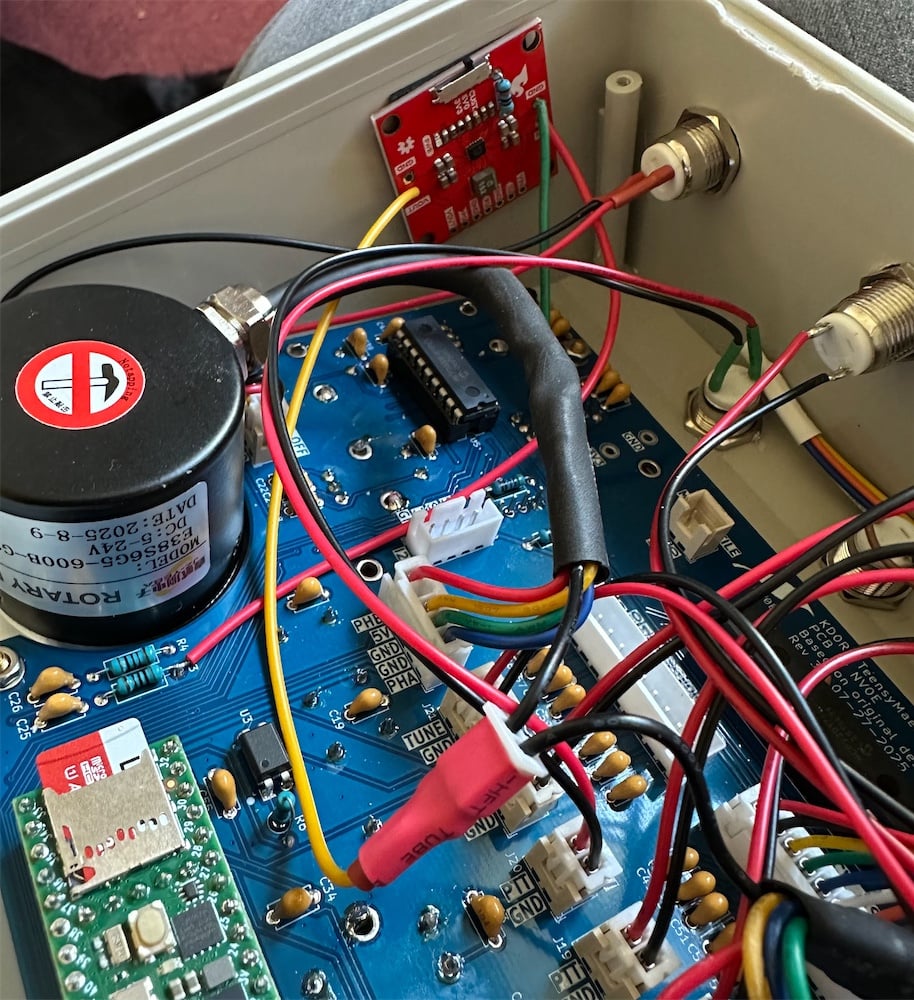

    Oleg,

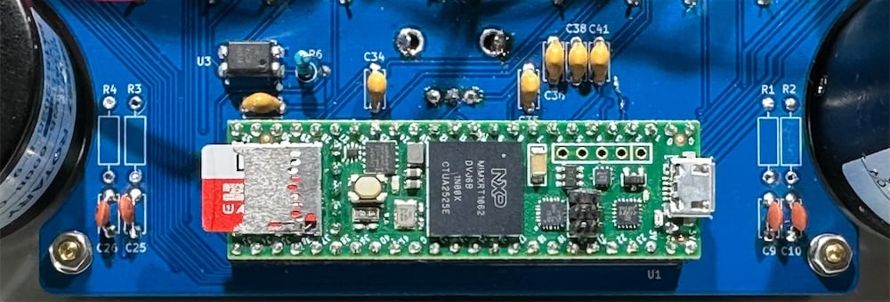

    from the picture it seems you are using "my" PCB-design, and this is really based on the H/W V1, despite the PCB says V2.0, that reflects it was a major redesign of the PCB, but this was done 2023 way before the new H/W V2 which came this year.
    The function buttons goes to J1 (i.e. into Mux 0)
    /Lasse SM5GLC

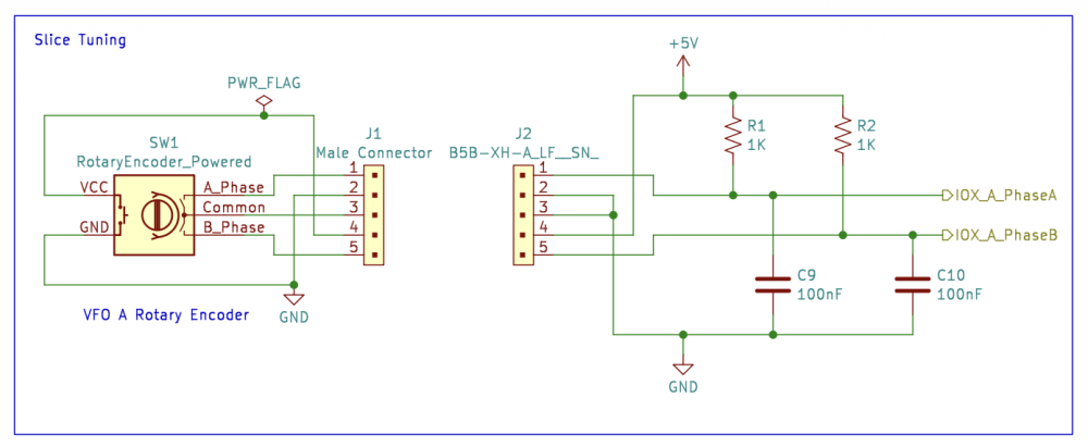

    Hi Len,
    The rev 2 hardware has the encoder open collector pullup resistors connected to 5v:
    I just pulled mine apart to check, the top end of R1 & R2 is at 4.75v and the IDX_A_PhaseX pins are at about 3.9v high level, I guess being clamped by the Teensy inputs? There's certainly more than 3.3v directly measured on the Teensy 4.1 input pins.
    This doesn't look right, I'm thinking about modifying my rev 2 board and moving the 4 pull-up resistors to 3.3v. I wonder what Simon thinks?
    73, Jonathan
  • NV0E
    NV0E Member ✭✭
    Hi Jonathan,
    You're right, this doesn't look correct. R1, R2, R3 and R4 should be pulling up to 3.3v not 5v. Len and I are discussing ways to best mitigate the issue.

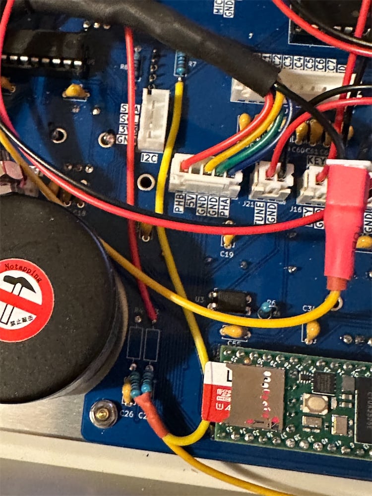

    In the meantime I thought I'd see if its possible to do an easy wiring mod in case we need to keep the pull-ups. I managed to do this without having to disassemble everything. I lifted the 5v end of the 4 resistors and found I could pickup 3.3v from the end of R7. Folding the resistors back over the capacitors eliminates the risk of them touching the 5v pads:
    Everything is working great, so at least we have that as a fall back mod. Will be interesting to see how you get on with enabling the internal pullups, as then we can simply clip out the 4 resistors.

    Solution 3 (Jonathan’s suggestion): Disconnect the top leads of R1–R4 and run bodge wires from each to the bottom lead of R7, using heat-shrink tubing to prevent shorts.
    Result: Though not ideal mechanically, this solution is straightforward and easy to understand.
    I've implemented Solution 3 on my board and will be testing it over the next few days. I’ve documented the modification thoroughly with photos. If Len and I are satisfied with the outcome, I’ll update the wiki with a detailed explanation. Ultimately, I plan to release a new schematic and PCB revision that resolves the issue cleanly.

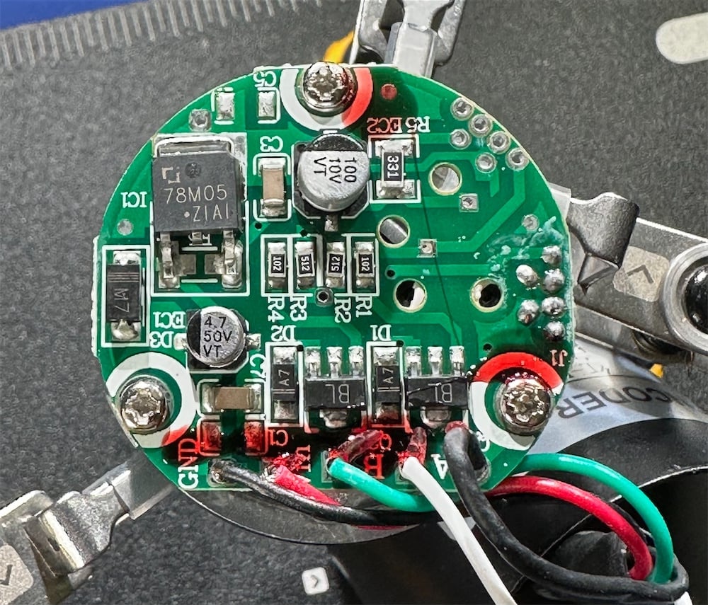

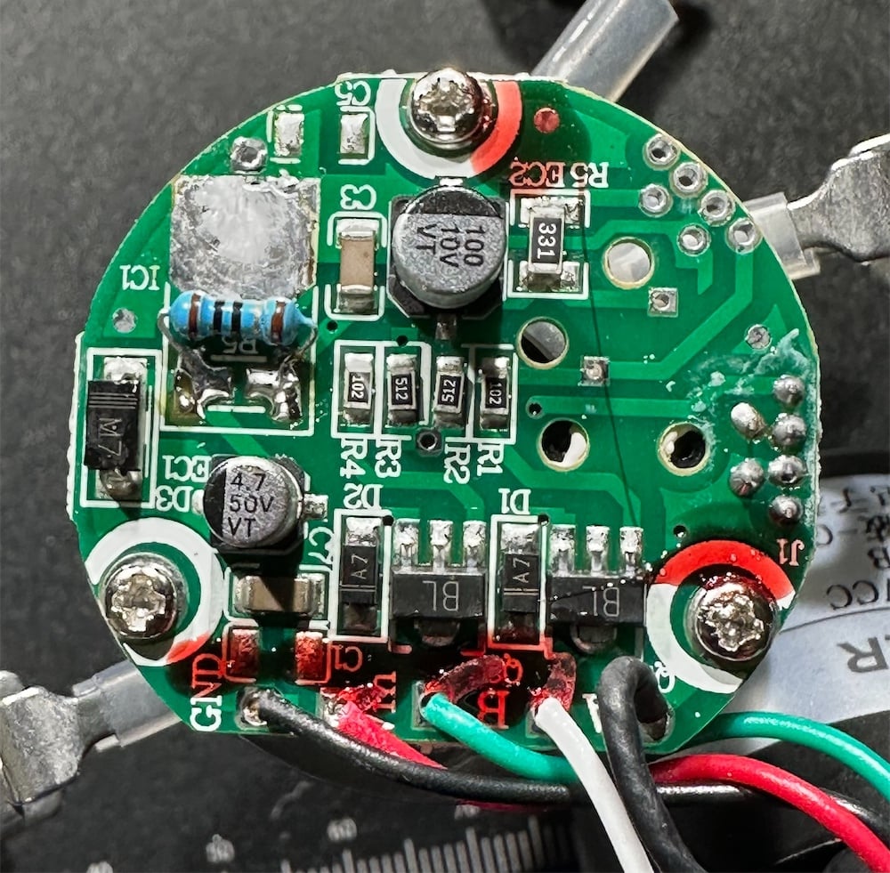

    I thought I'd try and dig a bit deeper to find out why my encoders didn't work at 5v and I had to install a buck/boost converter to get them to start up operate reliably. Whilst searching the web I found this video on YouTube where a chap investigates this problem with exactly the same encoder:
    https://www.youtube.com/watch?v=JvUNzHatPu0
    So I decided to open up my VFO encoders and sure enough:
    Well that 7805 explains why I had to feed in more than 5v to get it to work. In theory it should need about 6.8v to guarantee operation. Rather than simply wire across the regulator as suggested in the YouTube video I decided to remove the 7805's. This is pretty straightforward, the steps I used were:
    • cut the two leads
    • apply some fresh solder and soldering iron to the heatsink tab
    • after a few seconds the solder will flow under the 7805 and it can be lifted off with tweasers
    • then desolder the cut lead stubs and clean up
    There are 0805 resistor pads conveniently located to bypass the 7805, but I didn't have a suitable low value 0805 to hand. I could have just shorted it out, but as I had some low value leaded resistors (10Ohm) I used those for some in-rush protection:
    Final step after reassembling the encoders is to modify the voltage rating on the label with an indelible marker, otherwise I might forget in the future they can only be connected to 5v!
    Now both my VFO encoders are working reliably on the original 5v supply and the mystery is solved.
    73, Jonathan

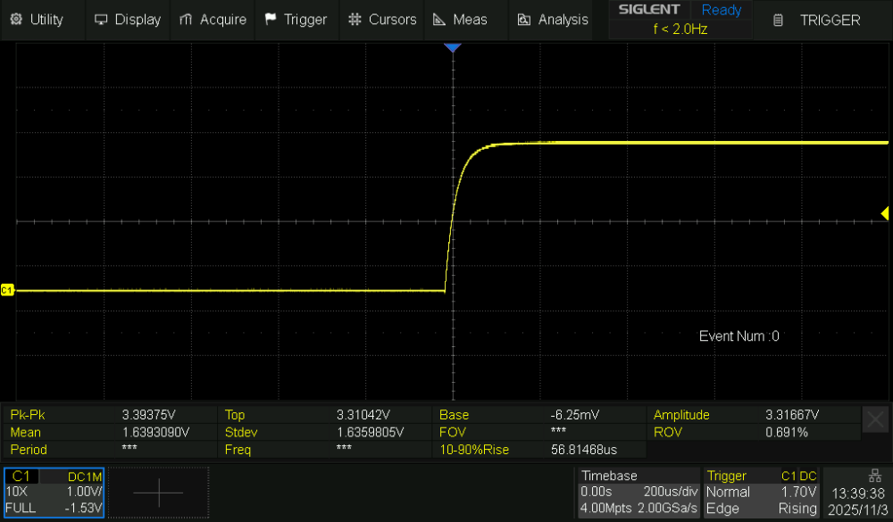

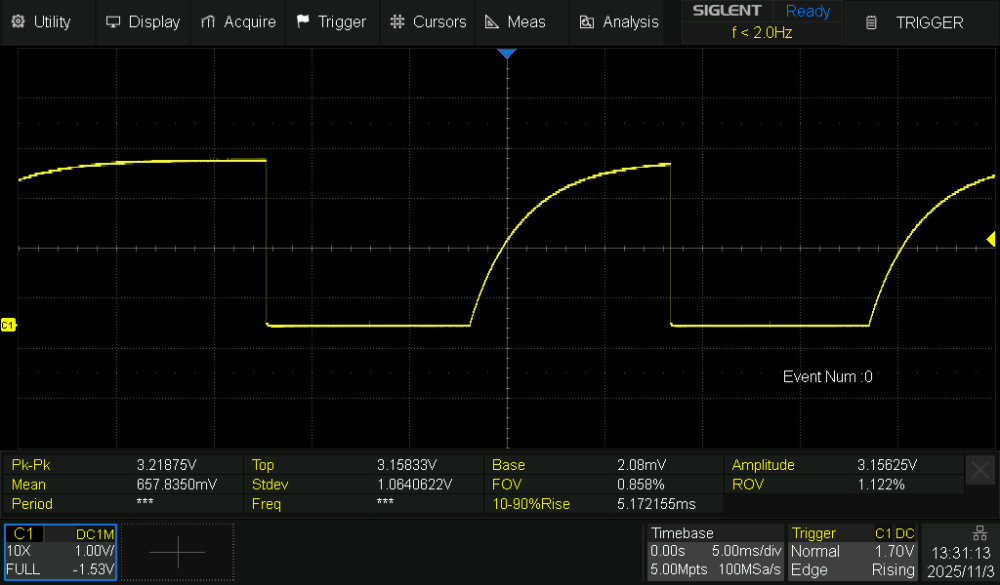

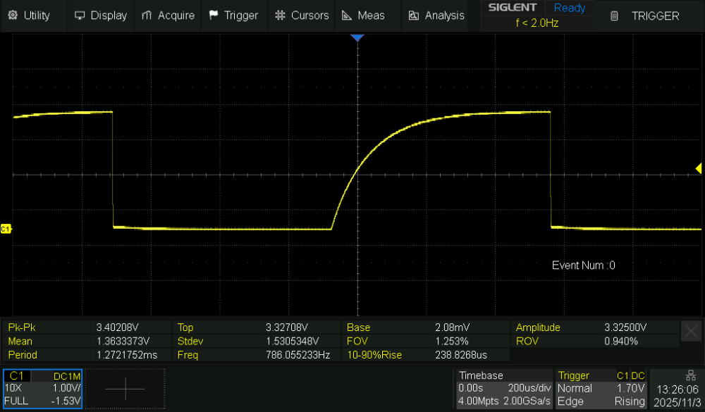

    I thought I'd take one more go at simplifying the VFO encoder 3.3v Teensy interface fix.
    SImon is right that relying on the internal Teensy pullups is unreliable because the time constant of the higher impedance of these internal pullups (we think somewhere in the range 50k-100k ohms) and the 100nF decoupling capacitors is around 5mS, much slower than using the 1k pullups.
    I setup my 'scope to measure the risetimes. First, here's with 1k pullups and 100nF capacitors:
    Interestingly I noticed that spinning the knob resulted in reduced signal amplitude, because at 600 pulse/rotation even this time constant is too large.
    Removing the 1KOhm pullups, but keeping the 100nF capacitors has the expected effect (slower 'scope timebase for this capture):
    The rise time is measured at 5mS as expected and not useable.
    But what if we reduce the capacitance? I replaced the capacitors with 1nF, which should give reasonable rise time and still provide some RF filtering:
    Bingo! 57uS rise time and a nice clean 3.3 volt logic signal from the encoder.
    Encouraged by this I replaced all 4 encoder capacitors, so the final modification is really simple:
    • remove the pullup resistors
    • swap the 4 capacitors for 1nF ceramics
    This is now working very reliably for me, and doesn't need any board modifications.
    73, Jonathan

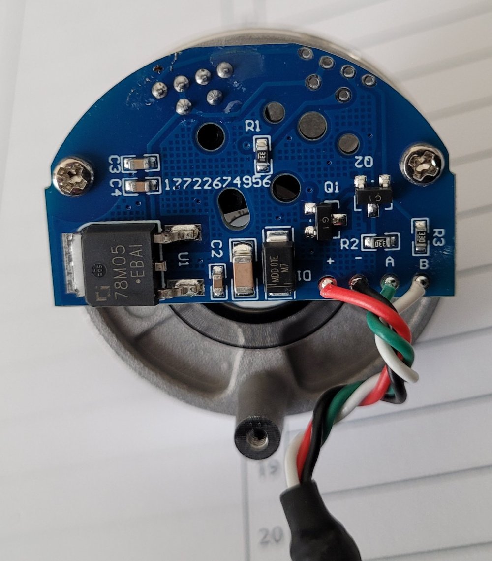

    Hi Jonathan,
    The PCB for my encoders looks very different than yours - a much simpler circuit. While there is still a 7805, I see mine doesn't have the A7 diodes (D1 and D2) that yours has. Are they connected to the A and B outputs on yours? Perhaps the forward voltage drop of 1.1v is problematic?
  • g4ivv
    g4ivv Member ✭✭
    Interesting Simon that yours does work with the 7805 in circuit - I guess how those regulators work at below minimum input voltage might well vary from vendor to vendor.
    Sadly my photos aren't quite clear enough to be definitive on those diodes, but I'm fairly sure that they are connected between collector and emitter (ground) so are probably designed for reverse polarity protection. On my 'scope traces the open collector low voltage appears to be around 0.5v (sorry I didn't measure that) so I don't think there's any diode forward bias voltage offset in the A/B phase outputs. It just looks like a normal open collector output.
