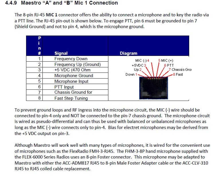

I want to get my FHM-2 mic that came with my Maestro + Flex-6600 working with the Maestro. the FHM-2 mic that came with the Flex-6600 is wired for the flex radio base station. The cable for connecting the mic to my Maestro is on the store but out of stock. Is there a pinout somewhere so I can wire my own? (Tried an ethernet cable but this did not work.)

I using my Flex6 hand mic with a normal LAN cable at Maestro. I disconnect the original cable direct behind hand mic, plug LAN cable into Maestro and hand mic - ready! No problem. It must be 1:1 wiring !

I must be missing something here. Where is the 8-pin mic connector on the 6600? I understand that he wants to make an adapter but wouldn't it be from the one of the TRS mic connectors on the 6600 to the RJ-45 connector on the mic?
EDIT: Is there an 8-pin circular mic connector on the Maestro?
EDIT2: OK, there is an RJ-45 mic connector on the Maestro. The pinout is on page 11 of the Maestro User Guide v2.x. Maybe that helps.
EDIT3: I believe this is the mic wiring so that should be all the info necessary.
https://www.qsl.net/o/oz1dgq//home-filer/yaesu-hints/yaesu-mh31a8j.pdf
A straight Ethernet cable is not working for me. PTT clicks in but no signal from the mic. Have tried several different ones.0
Exactly. I’m trying to connect to the RJ 45 on a Maestro that is controlling the 66000
I don’t think I need the modular pinout do I? The maestro has a RJ45 8 pin jack labeled Mic-1. I just tried a few different RJ45 cables. The PTT works but not seeing any levels. I have bias enabled,20db disabled.0
Where do you have the bias enabled? I'm not familiar with thee Maestro, is that where you enabled the bias? Can you measure any bias voltage coming from the Maestro on the RJ-45 Mic + pin?0

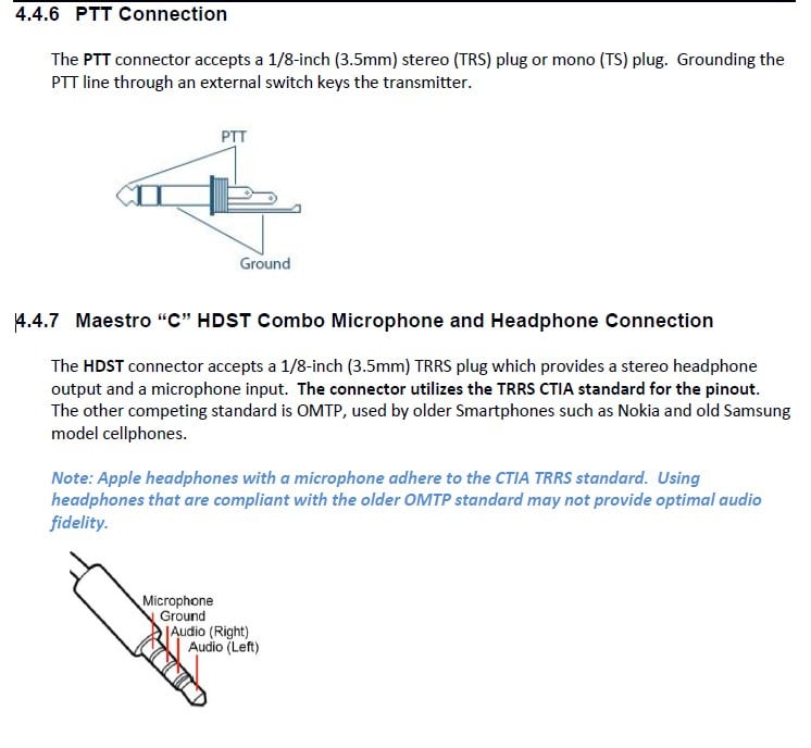

Here is the Adapter I made for the Maestro C, and it is VERY slick using a RJ45 female pre built cable, Pre built HDST Right angle cable, and a TRS Right Angle cables from Amazon.
I used Heat shrink to cover the connections
I USE NO Y cables or extra cables adapters It takes a bit of Soldering but not a lot.
I 3D printed some flat cable mounts that have the **** holes to use with a Nylon Tie. and used spare mounting holes to tie the cable up for a Permanent mount.
