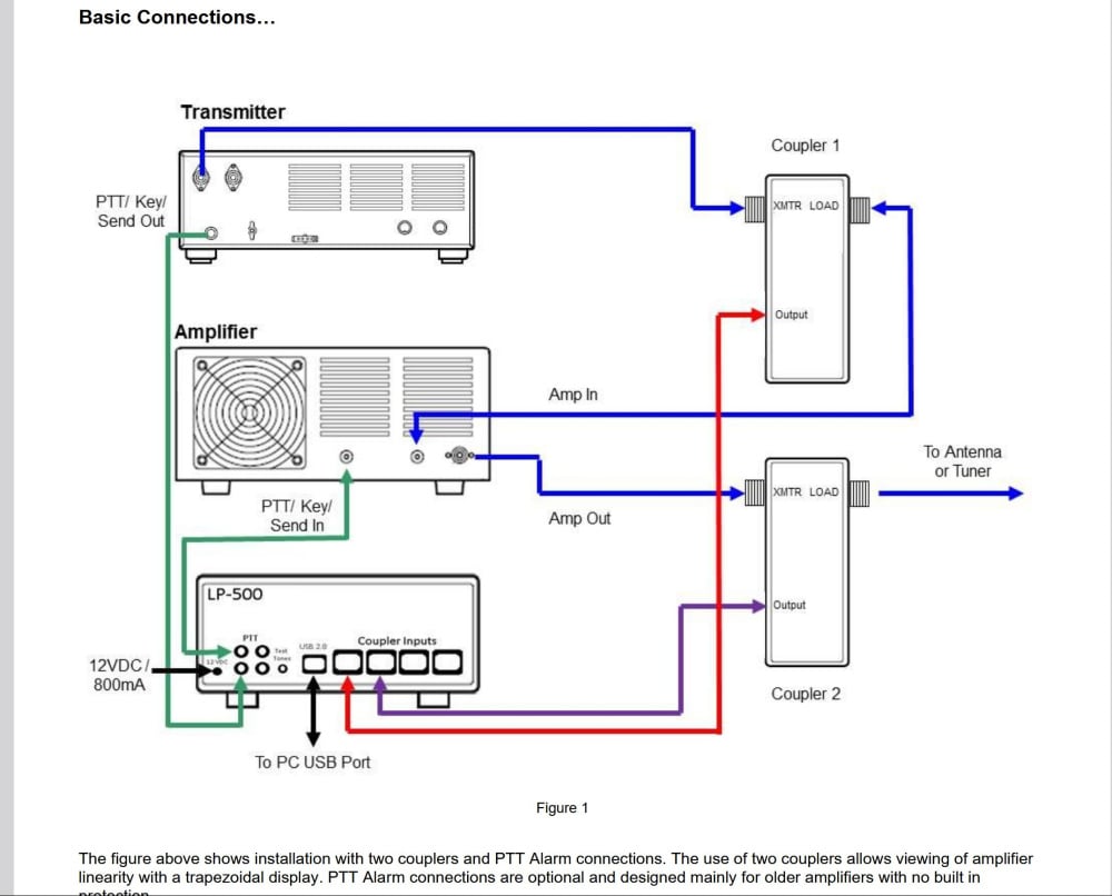

I have a hand held PTT switch on the 6600. Do I need these other two (GREEN) PTT cables, since I'm using the LAN cables to control the PTT ? Or should I add the two RCA cables per the drawing ?

Yes. The PTT out on the Flex 6000 radios can be set to the TX1, TX2 or TX3 RCA jacks using the TX Band Settings screen in SmartSDR.
So your PTT switch will connect to the PTT jack on the radio and TX1 (or 2 or 3 depending on what you set in TX Band Settings) will connect to PTT on the LP 700.

So no need for the PTT from the LP 700 to the amplifier (PGXL).
Yes, you need it from the LP700 to the amp.
The way it works is that the handheld PTT switch keys the rig. The TX1 jack then keys the LP700 which presumably has a small delay to protect itself before passing the PTT signal to the amp.

I have an LP-700, and do not make use of the PTT Alarm. Thus simplifying the connections - PTT only between my FlexRadio and my (non-Flex) amp, without involvement of the LP-700. But it is possible that this additional, optional PTT connection to the LP-700 brings value in some circumstances.

Gord-VA7GP, I keep having problems with "low tune power" on the TGXL after a few tests in my dummy load. I pulled the two green wires from the diagram and everything seems normal now. Since the radio amp and tuner talk to each other anyhow why use those wires with all Flex equipment? I could be wrong, I don't mind a correction, if anyone sees this as a bad choice.
As I mentioned, I do not use those two PTT connections which are shown.
But you made me curious: I thoroughly read, and re-read the LP-500 (LP-700) manual, and cannot see any sort of actual description of what these connections do. They perhaps seem to be simple relay-isolation jacks, where a solid-state transmitter (like our FlexRadios) could safely key an amplifier with high or negative voltage. It does not seem that there is any timing or sequencing involved; the way I read and understand the sparse information - it almost seems like a simple Ameritron ARB-704 keying-isolator.
And that's not making things clear at all about why your setup doesn't like it, when the LP-700 is connected… I could only hazard a guess that the internal isolation-relay may add just enough delay (few milliseconds??) that things are wonky…. but that's speculation on my part, based on the manual-wording where the only help is the phrase "PTT: For older amplifiers, loop the PTT (send, amp keying) between your amplifier and rig"
If you don't need it, and things are working, and your Flex 6600 is surely compatible with your PGXL, then it seems best to omit that green PTT wiring entirely.
