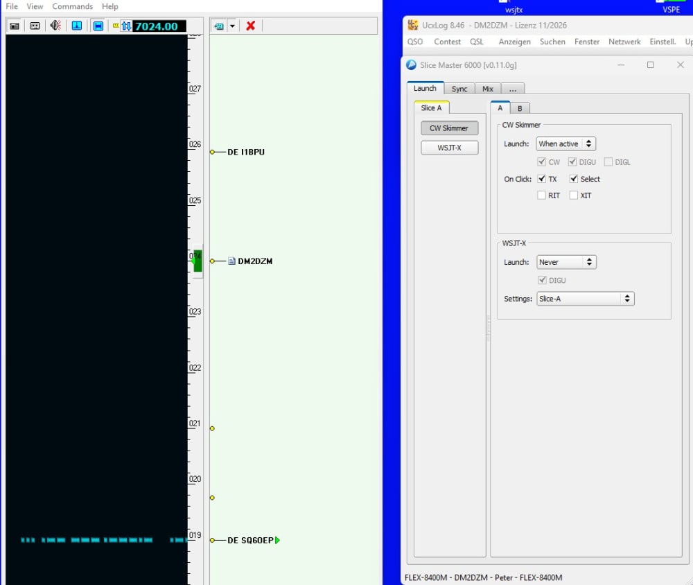

  • DM2DZM
    DM2DZM Member ✭✭
    hi all is now very good here
    73 de Peter
  • Alex - IK5PWJ
    Alex - IK5PWJ Member ✭✭
    Hi Peter, thanks for the screenshots and at this point the problem is solved or rather it is not present with your Flex 8400M. Can you confirm that you are using the v3.10.15 release on your Flex 8400M? I have a Flexradio 6600 and with slice-master v0.11.0g with Windows 11 Pro and it does not work even with the latest version v.3.10.15? So I went back to version v.3.9.19 and slicemaster works again. At this point the difference is the radio... your 8400 and my 6600. I hope the administrators of the Flexradio group do something to solve this problem. I should point out that I sent emails to DOM K1DBO again but he did not respond to the two messages I sent him, the first 2 months ago and the second 3 days ago. We'll see in the next few days... I wait confidently. 73 Alex ik5pwj
  • DM2DZM
    DM2DZM Member ✭✭
    Hej Alex, yes i have 3.10.15 now
    73and Gl de Peter
