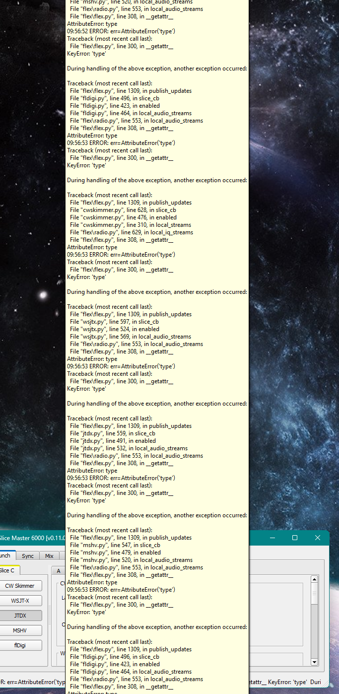

This is the message...let's see what he says. Thanks.Hi Don, I'm Alex ik5pwj, sorry for the inconvenience, but unfortunately the program you created, SliceMaster, no longer works with the new FlexRadio v3.10.10 release.
I contacted the administrators on the FlexRadio chat to find out what to do.
They replied that they're willing to work with you, but after more than two months, there's still no solution. I'm copying my message below,
along with a screenshot of the errors. I hope these problems can be resolved.
Thanks in advance.
The problem I'm experiencing with the Slice Master program is this:During handling of the above exception, another exception occurred:Traceback (most recent call last):File:"flex\flexpy!,line 1309,in publish_updatesand other error etc.
And it won't open any WSJTX program, JTDX is all blocked.How do I fix this?I'm forced to revert to SmartSDR v3.09.19.
The errors reported above after opening a slice for JTDX, WSJTX, or CWSKIMMER don't work.
73 Alex ik5pwj
