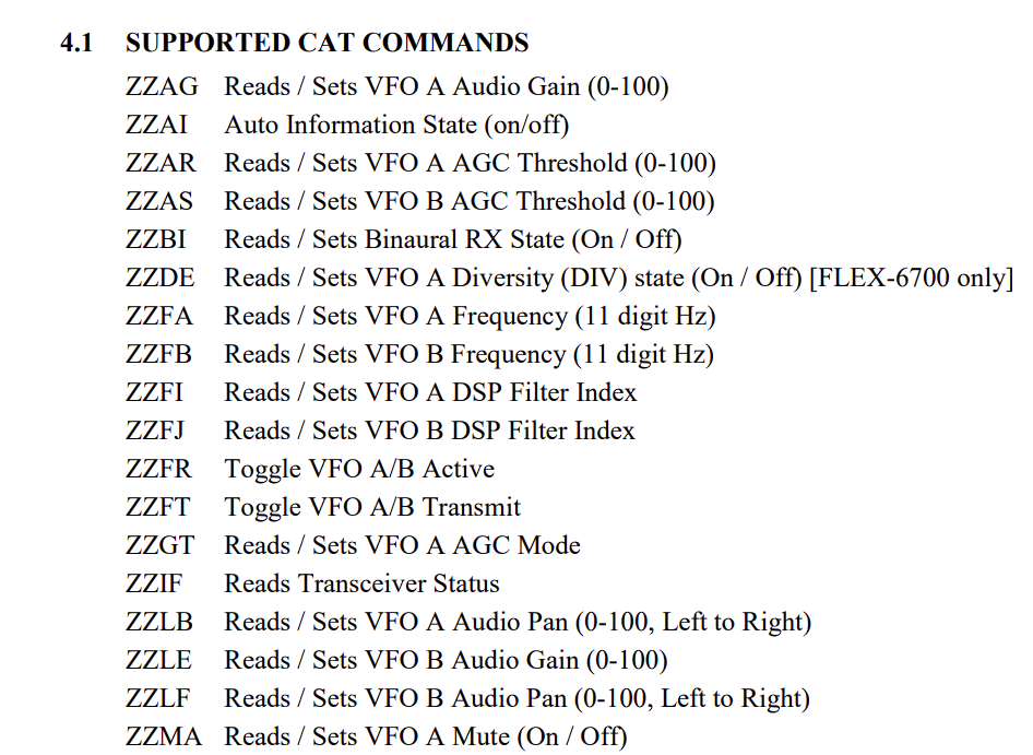

There is a way to do what you are asking for ( I think). I developed a usb footswitch that sends cat commands to toggle MOX .
This works very well. It could be modified to include CAT commands to Toggle VFO A/B to active (ZZFR), set the VFO Pan (ZZLB) when the foot switch is depressed. Up on release you could set the VFO A pan to Left and the VFO B pan to Right.
Since you are using 2 foot switches the code would be reversed for the 2nd foot switch. Obviously it would need to be tested. I am betting you will need to be running split to do this.
You could take my code and modify it to add the CAT commands. The project uses a Arduino Nano Every to send the CAT commands to the Flex
Here are the CAT commands…
