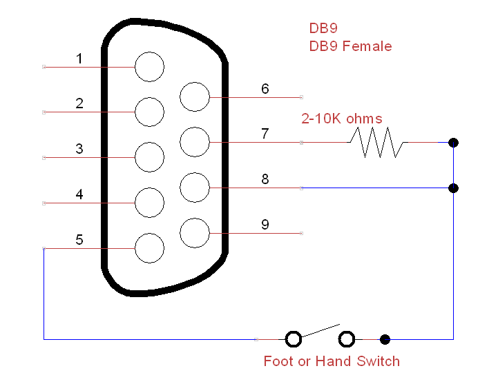

    Hi Przemek
    What you want to achieve is possible.
    At MD7C I use 2 footswitches which are each connected to an RS232 to USB (FTDI) adapter, this creates a com port in windows. You can then assign a port to each slice, so FS 1 for Slice A and FS 2 for Slice B.
    If you have USB footswitches that create a com port, no need for this.
    In SmartCAT create 2 x PTT for both footswitches and assign to the relevant slice.
    Also in SmartCAT create an OTRSP port and then assign this to the same port in your logging programme. This will handle the audio switching you require.
    I have this working with DXlog if you need screenhshots of the set-up.
    Rich
