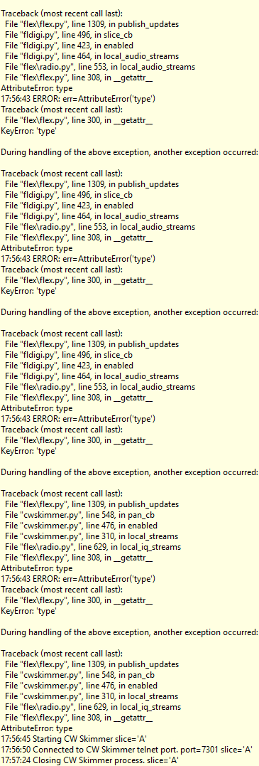

The problem I'm experiencing with the Slice Master program is this:During handling of the above exception, another exception occurred:Traceback (most recent call last):File:"flex\flexpy!,line 1309,in publish_updatesand other error etc.
And it won't open any WSJTX program, JTDX is all blocked.How do I fix this?I'm forced to revert to SmartSDR v3.09.19.
The errors reported above after opening a slice for JTDX, WSJTX, or CWSKIMMER don't work.

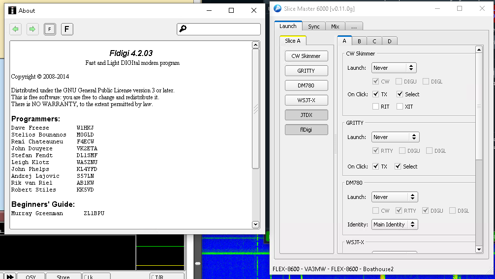

-1 -
I am here to confirm that on my Flec 8600 with 4.0.1 Slicemaster 0.11g it does not work here too same error as Alex @Alex - IK5PWJ and impossible to start WSJTX, I wrote to Donald, hoping that he reads my request for support, we are now so dependent on these third-party programs that when they do not work we feel frustrated... we hope for an update that solves the problem, which apparently is not present for all users.
