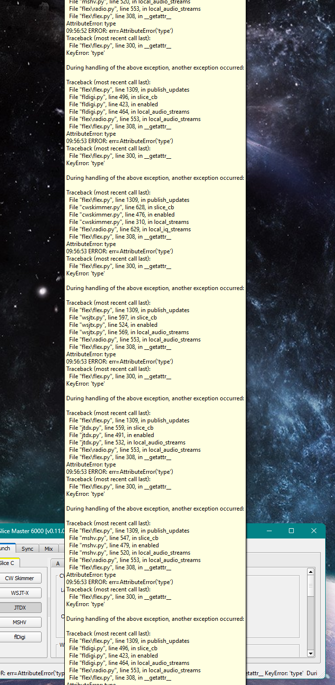

Hello, unfortunately, with the new 3.10.10 update, there are some problems with the Slice-master.v0.11.0g software.
The problem I'm experiencing with the Slice Master program is this:
During handling of the above exception, another exception occurred:
Traceback (most recent call last):
File:"flex\flexpy!,line 1309,in publish_updates
and other error etc.
And it won't open any WSJTX program, JTDX is all blocked.
How do I fix this?
I'm forced to revert to SmartSDR v3.09.19.
73 Alex ik5pwj

    but unfortunately, on two computers with Windows 11 PRO 64, Slice-Master v0.11.0g doesn't work with firmware version v3.10.10.
    I tried reinstalling both Slice Master and the firmware, but unfortunately this is the error I get. Slice Master doesn't open JTDX, WSJTDX, or CW, anything. However, if I revert to version v3.9.19, everything works.
    Here are the screenshots of the errors:
    The problem isn't in the Windows11 Pro firewall.
    Unfortunately, I have to revert to firmware version v.3.9.19 for now, hoping the administrators will fix the problem.
    Thanks
    73 Alex ik5pwj

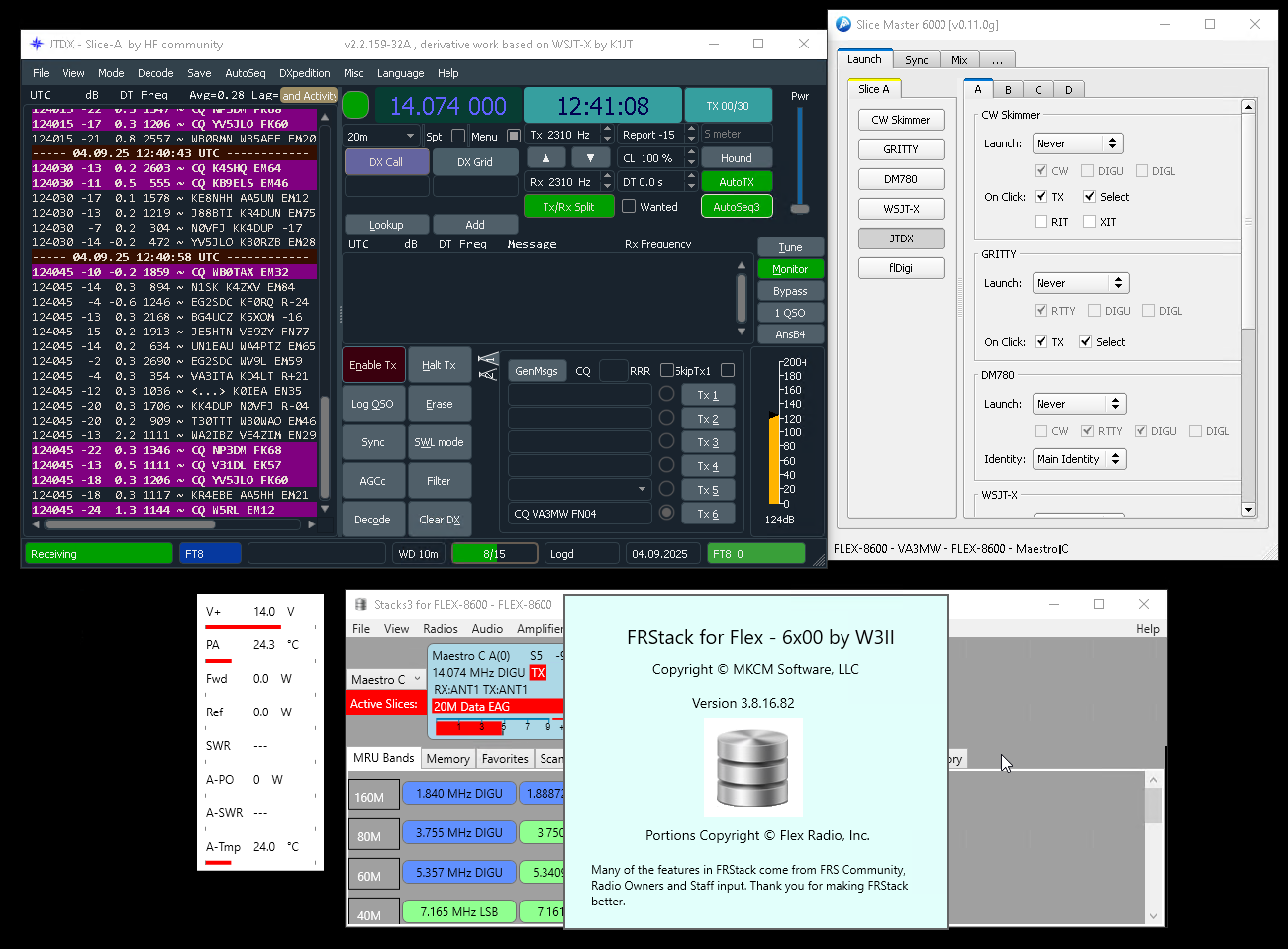

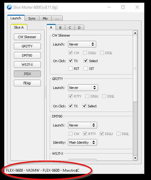

    Alex, please email the author of SliceMaster. He may not be aware of your issue and I don't think Don monitors this group at all.
    I just tested this morning with both SliceMaster and FRStack and I do not seem to have an issue.
