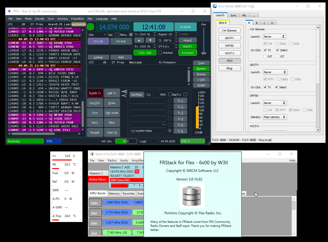

    Hello, unfortunately, with the new 3.1.10 update, there are some problems with the Slice-master.v0.11.0g software.
    The problem I'm experiencing with the Slice Master program is this:
    During handling of the above exception, another exception occurred:
    Traceback (most recent call last):
    File:"flex\flexpy!,line 1309,in publish_updates
    and other error etc.
    And it won't open any WSJTX program, JTDX is all blocked.
    How do I fix this?
    I'm forced to revert to SmartSDR v3.09.19.
    73 Alex ik5pwj

    Alex,
    It sounds like your windows firewall is preventing some communication. Can you turn it off and see if that issue?
    mike

    I just came to report the same. Slice Master 6000 v0.11.0g worked fine under SmartSDR v3.9.19, but throws a whole fleet of errors when using SmartSDR v3.10.10. @Mike-VA3MW I can submit log files if you like, but they contain my radio serial number and other details, so I didn't want to post the full log here. Here is a sampling of the errors that Slice Master throws:
    2025-09-04 10:07:02,265 ERROR  flex.flex.Flex6000.publish_updates err=AttributeError('type')
    File "flex\flex.py", line 300, in __getattr__
    KeyError: 'type'
    File "flex\flex.py", line 1309, in publish_updates
    File "cwskimmer.py", line 628, in slice_cb
    File "cwskimmer.py", line 476, in enabled
    File "cwskimmer.py", line 310, in local_streams
    File "flex\radio.py", line 629, in local_iq_streams
    File "flex\flex.py", line 308, in __getattr__
    AttributeError: type
    2025-09-04 10:07:02,266 ERROR flex.flex.Flex6000.publish_updates err=AttributeError('type')
    KeyError: 'type'
    File "wsjtx.py", line 597, in slice_cb
    File "wsjtx.py", line 524, in enabled
    File "wsjtx.py", line 569, in local_audio_streams
    File "flex\radio.py", line 553, in local_audio_streams
    2025-09-04 10:07:03,008 ERROR flex.flex.Flex6000.publish_updates err=AttributeError('type')
    KeyError: 'type'
    2025-09-04 10:07:03,124 DETAIL flex.smartlink.WanServer.parse_reply unknown reply reply='error| invalid command'
    There's actually a lot more, but most of it is a repeat of the lines I included above. Just launching Slice Master and closing it again after about a minute generated 1400+ lines of log messages.
    Please contact Don at SliceMaster with this.
    I am not seeing the same issue at all on my station but it seems there are some corner cases regarding this.
