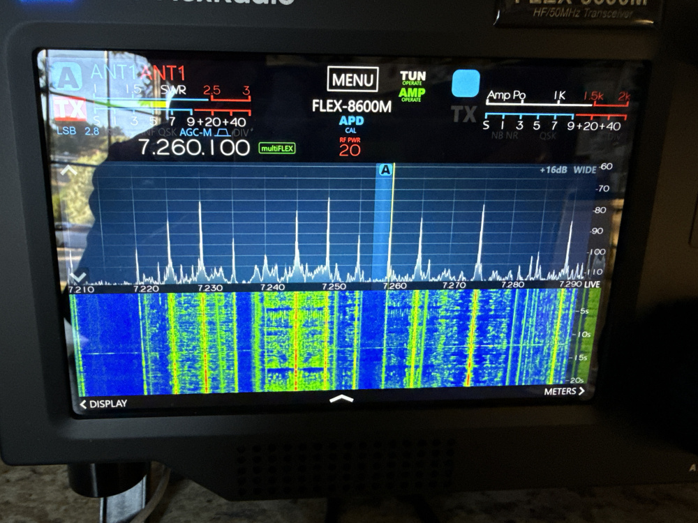

I have a remote user via MultiFLEX over the WAN. When I am locally using the 8600M and want to put the radio in a Standby condition, how do I do this? Does the remote user still have access?
What I have needed to do is open my SmartSDR app on my iPhone and shut my end down. I am thinking there must be a way from the screen on the 8600M.
Pushing the 8600M Power Button turns the radio off and I do not believe at this point there is WAN access.?

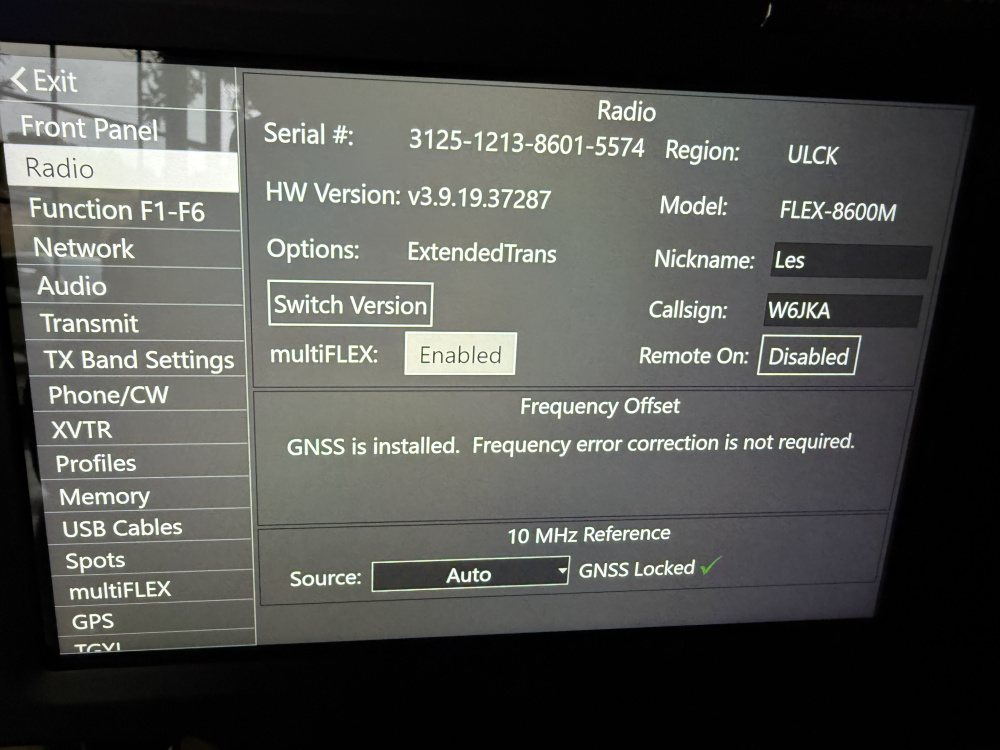

    My Maestro is attached. Apparently there is some difference between a stand alone Maestro and 8600 and the 8600M
  • Erik Carling EI4KF
    edited August 23
    That is a multi-step move: Menu>Radio>Switch Version>"<Radio" (top left of screen). However, I can remotely access it in that state so it does not solve anything. Disconnect it from Internet is my probably useless answer. Someone may know better. Powering off though does terminate remote access.

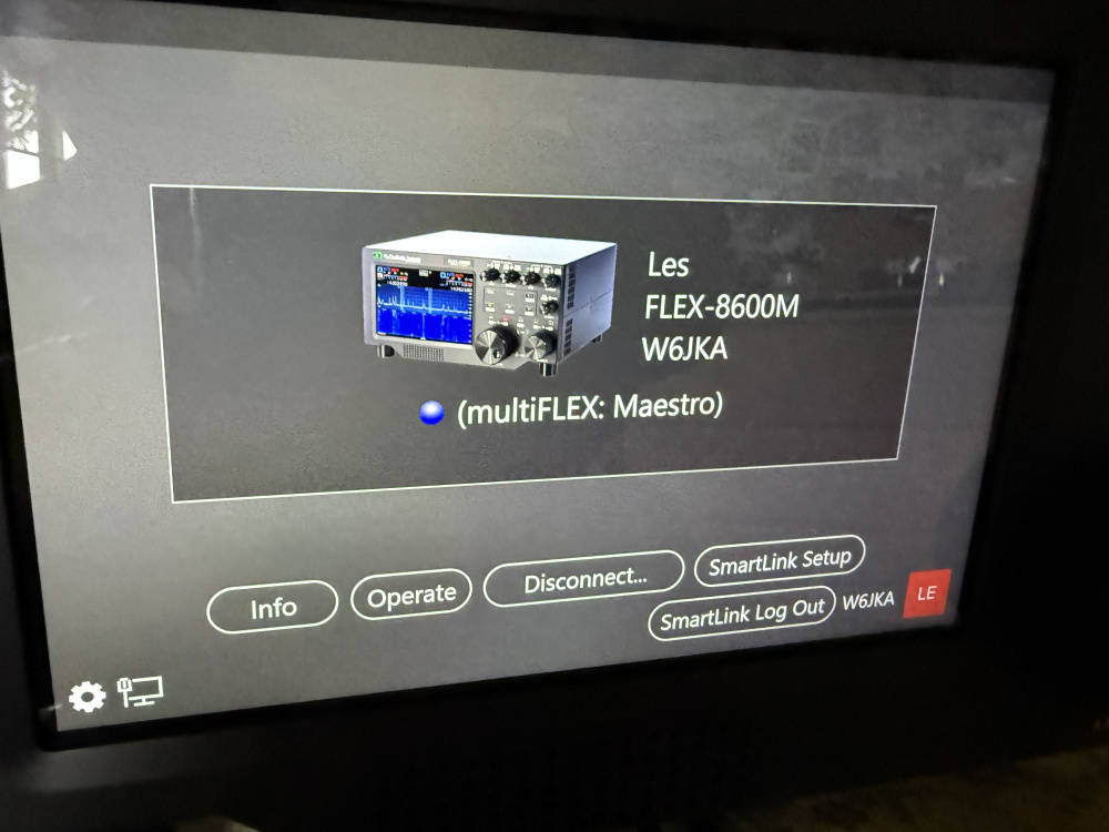

    With the display in normal receive/pan mode I want to return to the starting screen where you would select the firmware version and run. At this point I believe the radio will be available for 2 connections. Not sure just how to articulate this. I can get the flex to do this only by signing into it via my iPhone or iPad and disconnecting the local connection.

    Want to get back to this screen without shutting down radio entirely
    I think you need to press the Disconnect… button to make 2 connections available. In your picture, I see that it still shows multiFLEX, which indicates that the front panel (or standalone Maestro) is still connected.

    Where is the disconnect button from this display?
    It is on the other display that you showed. I think that you get there by tapping the Menu box on the main screen. I am not sure which menu item to choose that lets you choose a different radio, but that is where you want to go.

    From the Receive/Pan normal display there does not seem to be a way to go back to the display that shows operate
    There is, and I think it is by tapping on Menu on the main screen. I just don't know which menu item takes you there.

    None take you back to the screen that says Operate. Only way to get there is to go to SmartSdr App on iPhone/iPad and Disconnect that way.
    Do you see one that says something about choosing a radio? That is the one that you need.

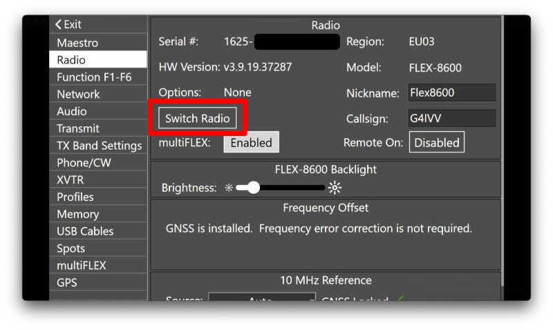

    On a standalone Maestro:
    Menu → Radio → Switch Radio
    This takes you back to the screen with the connect/disconnect buttons. Is this not the same on the M models?

    I realise that, but don't you have the "switch radio" button?
  • VE7ATJ_Don
    VE7ATJ_Don Member ✭✭✭✭
    Les is right, for an 'M' model, the display is literally 'attached' to the radio, so there is no option/capability to switch the display to connect to a different radio (like you could if you have a standalone Maestro).
    Sorry Les, barring any further input from a Flex employee, I don't believe there is any way to achieve what you want to do. On the M models, the display is directly attached to the radio server and it appears you'll need to leave it on and running to allow your remote user to continue to use the server.
