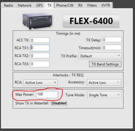

WE HAVE FOUND THE SOLUTION TO THIS ISSUE!
With thanks to Len KD0RC, it was found that the MAX POWER setting under the TX tab in "Radio Settings" overrides any setting in the "Profiles" TRANSMIT PROFILES TX BAND power and relay settings grid GLOBALLY for each and every TX Profile recalled!
This means that it doesnt matter what the power settings are in the TX PROFILE grid, radio output power will be set by the power setting in the "Radio Settings" TX Max Power tab, and this goes for EVERY TX PROFILE, no matter which one it was that Max Power was set under or recalled.
I wrongly assumed that the Max Power setting under the TX tab was connected to the TX Profile settings. It is not. Having set the MAX POWER at 35w, EVERY TX PROFILE resulted in a maximum power of 35w.
The confusing thing is that the TX Profile grid shows the power settings that you set IN THE GRID, and SAVES AND RECALLS them, however, it doesnt matter what the grid says, the "Boss" setting in this scenario is what is displayed in the MAX POWER box under the TX tab in Radio Setup.
In retrospect, the behavior makes sense, however, what doesnt make sense is that the TX Profile grid shows a DIFFERENT output power setting, leading you to believe that this will be the power out recalled when you load the profile. It is not, the Max Power setting takes precedence.
It would be more logical if, when you set the Max Power setting in the TX tab, this power setting would then be automatically reflected in every TX Profile grid that is recalled. As it is, you have to REMEMBER the setting in Max Power and know that this is the most RF power the radio will output GLOBALLY, regardless of what you input or what is recalled in the TX Profile power out grid. Recalling a TX Profile WILL NOT affect the Max Power setting regardless of what the TX Profile Power out grid says.
