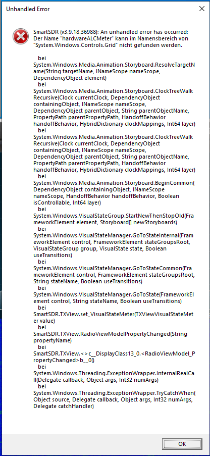

SmartSDR 3.9.18 does crash with HWALC engaged
Hello!
I'am using FLex6500, S.P.E. Expert 2K-FA and SmartSDR 3.9.18
HWALC is activated and a PA connected with ALC-line.
As soon as ALC voltage rises above 0 Smartsdr 3.9.18 does crash.
(Earlier versions of SmartSDR with same configuration worked).
Please not discussions of using HWALC!
Any idea?
73, Hardy
Hi Hardy, I would do a factory reset (export profiles first). If that does not resolve the issue, submit a help desk ticket.
The malfunction remained.
Malfunction same on 3.9.19
Maesto (A) with 3.9.19 does work fine.
Hi Hardy, you should submit a help desk ticket.
Hardy has submitted a ticket and engineering is review it.
The fatal error still exists with version 3.10.10
Instead of protecting the amplifier in case of overload, SSDR simply crashes at FULL power!
