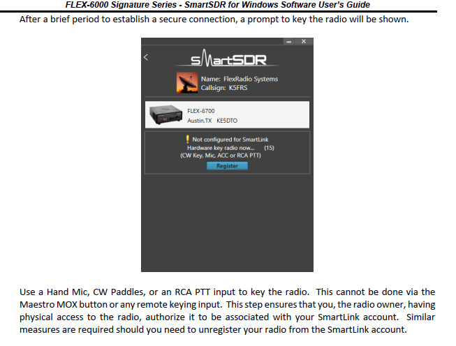

I guess I misunderstood. I thought I could connect to my 8600 from anywhere just by using SmartSDR. I can’t. I tried setting up Smartlink which I guess is for working away from home but it said during registration that PTT timed out and registration failed.
I think I’m missing something here!

    Normally, you can only register the radio for Smartlink when you have local access to the radio (hardware PTT/CW). Once registered, you can operate from anywhere ( provided that the network radio-ISP interface is properly configured )

    am I supposed to push the PTT while registering?

    ok I have it working.
