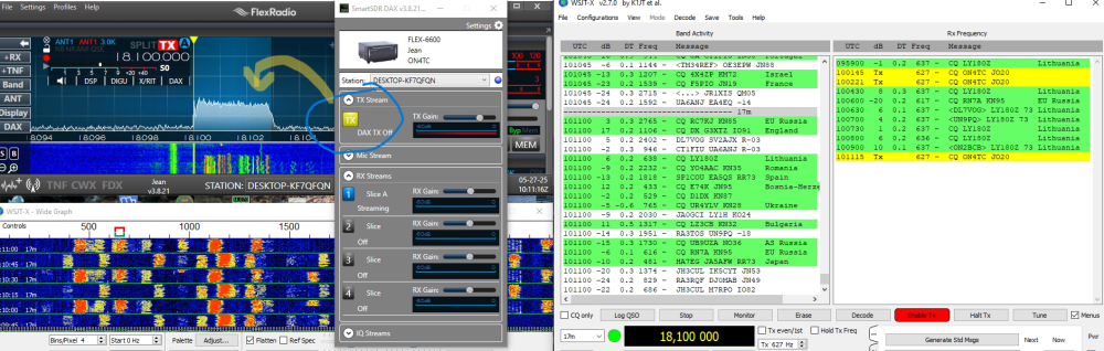

I'm helping a friend because we're facing a problem we can't seem to resolve. When using wsjt-x, the PTT remains yellow and won't turn blue. It transmits via USB even though it's programmed in DGU. What should I do?

It's easy with a screenshot.
The modulation is like SSB, which is not normal. I think I checked everything correctly!
Albert,
That is not PTT. That is the DAX GUI TX stream button. The likely cause is that the SSDR Phone/CW panel does not have the DAX button enabled.
AL, K0VM
Now is OK,
Thank you very much Al, it was really a **** oversight.
