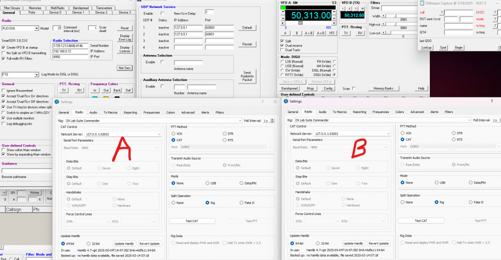

But when I have two instances of WSJTX open when I change frequency from one they both change. If I click a decoded call in A both slices in SSDR move to the same frequency as does WSJTX and DXL.
I know I am close but pulling my hair for past 3 days trying to get this right with no luck.

    Looks like you have both A and B set for same TCP COM port. In CAT you want one TCP com port on slice A and a different TCP COM port for B.
    I would suggest then using a program such as JTAlert as middleware between the two instances of WSJT-X and DX Labs. In JTAlert there is a setting under logging to use DX Labs.

    Hi Dave. I spent a few hours setting up with WQ6Q who is using this setup. The problem was Dave insisted on using the DXCommander protocol in WSJTX. Instead we used the Flex Slice A to Slice D protocols which then treats each slice as a separate radio. He then showed me how to setup JTAlert as I had no experience with it. No I can run 4 slices - 4 instances of WSJTX and 4 corresponding instances of JTAlert. All seems to be running well. Hope you got some rest!!! I am going to try to go next year.
