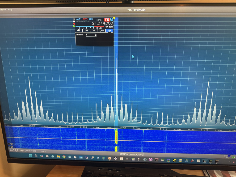

Looks like over driving?
W2PP
W2PP Member ✭✭✭
I went into DAX and kept reducing tax and the output power went quite low. I have the DAX drive set to 45. To my eye this looks pretty dirty.
what advice would you have to clean this up?
Thanks
Peter

    As I remember part of the tx monitoring function involves the RX circuitry,. What is your RX RF gain set at, it's value is displayed at the upper right corner of the Pan fall. You are probably over loading the RX. Turn the RF gain down, I can duplicate your problem with the RF Gain setting over +16dB.

    yes that’s it. Those spikes are down around-100db. The primary signal is closer to zero db.
    I have the RF gain set to +8 db. All ok

    Hi Peter, glad to see you got your unit. Great news.
    can you show the complete screen shot with the scale on the right.
    You may also want to have a look at the RF actually transmitted as that is before most of the filtering. I doubt is is going out on the air.

    thanks everyone. Correct signals are clean
    clicks drop outs. Had what appeared to be a good cable but clearly it was not a good cable. Replaced it and signals are stable without dropouts.
