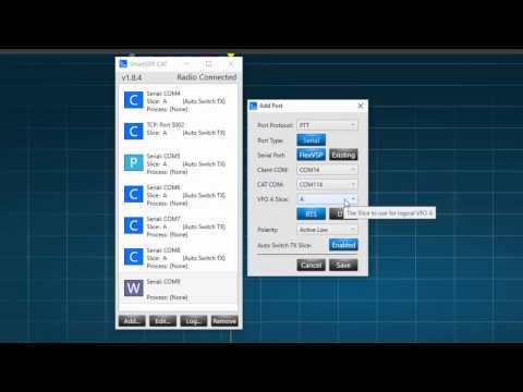

Hi, here is a link:
https://youtu.be/zJqAUZpEIgY 0 -
this will help also
https://www.flexradio.com/downloads/flex-6700-so2r-configuration-n1mm/
it refers to 6700 but the setup guidance is good across the platform

- So have followed the setup instructions in the Flex Configuration guide: "Setup for SO2R Mode with a FLEX-6700 and N1MM+" (doc states also for 6600)
- When I open N1MM+ all is operating as advertised, but with Slice A & B on different freqs, the N1MM Entry window 2 for Slice B is showing the same frequency as window #1 for Slice A - . I have two separate CAT ports setup in SSDR CAT for radio 1 & radio 2 and they are assigned that way in N1MM+ configuration.
- I have verified the setup instructions 2x without solving the issue. Any suggestions on where to look to correct this error??
