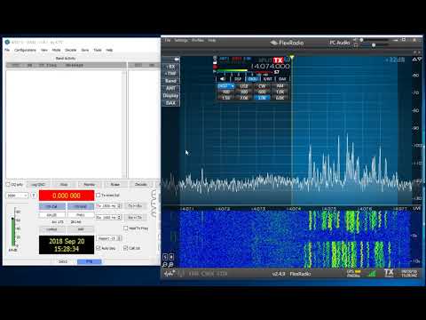

I just posted this, but there is a few mouse click setup for FT8 using SliceMaster that does the configuration for you.
https://www.youtube.com/watch?v=Sj85yjVcTTk
