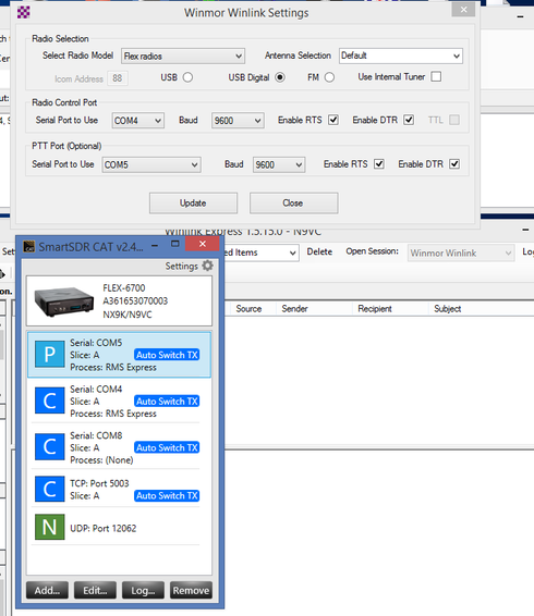

    Yep, that's selected. When I do a TX test in RMS I can see the audio TX data in DAX as it sends the test tones but my FLEX will not go in the TX mode. Have tried several PTT settings in the RMS Radio Setup but no go.
  • Member ✭✭
    edited November 2018
    GOT IT! Had to make a VSP for PTT. Now I see what the "P" is in the SMART CAT examples. Thanks.

    Your DAX is recognized in your second photo (Process = RMS Express) - which is good. I can't see you're entire CAT screen - do you have a P-com (PTT) to key the radio?
    Two additional suggestions I would make: 1) adjust slice A Rx gain higher until it is 25-50% across the TNC receive level (make sure you're computer sound devise is at 100%) and, 2) do not enable DTR on either port - I've found that enabling this will halt all coms (on my set-up anyway).

    Hi,
    I think you have to set your PTT port in
    CAT so it is the PTT port. Look at my CAT
    setup and you can see the CAT protocol for
    COM 5 is set to P for push to talk.
    73, Jim N9VC
