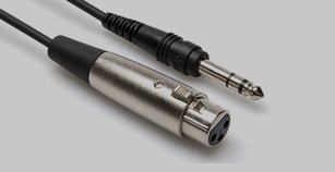

Hello ....
I wonder if this is the conector I have to buy to use my Heil Sound PR40 with the new Flex 6600
cause I have heard jack is gonna be 1/4
Part Number acc-stx-310f
Thanks

Looking at the pictures on the site, I don't see a 1/4" jack anywhere. Looks like 1/8".
I have seen specs that says 1/8" TRS http://appello-funk.de/product_info.php?info=p827_Flexradio FLEX-6600 SDR Transceiver.html&XTCsid=412bb3a96fcb8f87c74be8b9fb3bfa77 73 Chris DJ2NL0
Flex announced a 1/4" jack for the 66001
Thanks Howard.....so....is it? right one?
The answer is ... perhaps ... if it is wired correctly. Some cheap supply houses wire these connectors with the pin 1 (which is the chassis/shield on the XLR and the sleeve on the 1/4 TRS) shorted to the -mic (which is pin 3 on the XLR and the ring on the TRS). Others simply connect pin 1 to the sleeve and pin 2 to the tip and nothing to the ring. Still others connect pin 3 to the sleeve and pin 2 to the tip with nothing connected to the ring. All three methods unbalance the cable and negate much of the noise rejection properties of using a balanced cable. They may "work" but may be susceptible to RF and other noise pick-up. So, if you receive the cable and test it before hooking it up, there should be no continuity between the sleeve and ring. And all three pins should be brought out to the TRS connector. One alternate way that I have seen is to have all three wires connected properly on the TRS connector, but leave the pin 1 shield disconnected at the XLR connector. This "ground lift" connection is more common when connecting two pieces of audio equipment together. It maintains a ground over the twisted pair balanced cable, but can eliminate ground loops in certain equipment configurations. I don't know that it would matter for a Mic. Ken - NM9P0

Description:This high quality balanced audio cable is used to connect a 3-pin XLR balanced microphones, like the PR-781 or outboard audio equipment to the FLEX-6000 and FLEX-50000's 1/4" Balanced line level input. Note: this cable does not have a PTT interface.Features & Specifications:
XLR and 1/4" TRS connectors with internal strain relief for rugged reliability
Oxygen-Free Copper (OFC) conductors for enhanced signal clarity
Hi-density OFC braided shield for superior EMI and RFI rejection
Conductor: 24 AWG x 2 OFC (90% OFC braid)
Connector: 3-pin XLR (female) to 1/4" TRS plug (male)
Length: 10 ft

Hi George! I missed that detail....too late at night...I would assume that if it is the Heil cable, or provided by Flex, that it is wired correctly.1
Of course you will need a dedicated PTT line or use VOX. I use a footswitch and thumb switch wired together so I cannot either one.1
Think that is the cable. But I personally don't care for the or-40. Better off with stock mic. Or a RE-270
