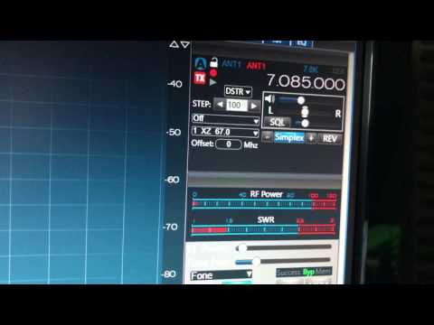

Hi everyone. I finally got my ThumbDV, no problem at all installing it following Ed's how-to. Now everytime I transmit it only gets out what its sounds like the header frames but not the voice frames. I made a short video keying up and down monitoring the modulation using an FM receiver.
https://www.youtube.com/watch?v=QG5XlceQEuE
Using Windows 10 x64 and SmartSDR 1.10.16 (no problem at all in any other mode).
Any help will be appreciated.
73 de Gaston
https://www.youtube.com/watch?v=QG5XlceQEuEUsing Windows 10 x64 and SmartSDR 1.10.16 (no problem at all in any other mode).
73 de Gaston
The ThumbDV has not been working for quite awhile now with SSDR. Flex is aware of the issue. Good news is that you can still use the ThumbDV with WinDV to get on the FM reflectors via the internet.0
This issue is in our bug tracker as defect #4457. I have added your info to the defect detail. Thank you for the defect report.1
Same issues for over a year on 6700...!!!
Gaston, Dudley and I are having dialog about this condition. I actually had a defective ThumbDV. However, I also discovered that if I use a USB hub on the remaining USB port of my 6500, I have the condition you are experiencing. If I unplug the USB hub, My unit does transmit properly.
73, Bob
Hi Bob, I just have an ACOM PA on the another USB port, no hub. Swapping USB ports and using powered hub doesn't change anything. The ThumbDV works fine using Windows 10. 73.0
