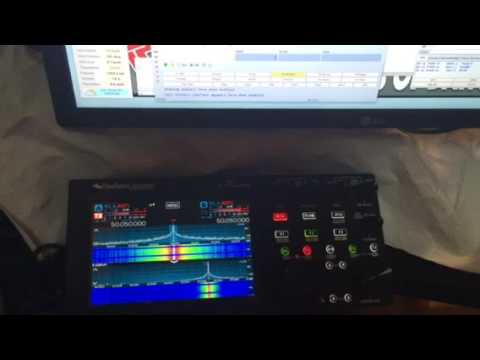

    Just to confirm this, I tried the test that Simon suggested and it seems to have a problem every other macro. The WinKeyer support in N1MM+ is pretty robust so I suspect it is something specific to the Flex implementation although I can't get DM780 to exhibit the same problem? Here is a video. You will notice that alonw with sending 2E0DSK alternately, it also sends 2E0DMQ at the end!

    I just did a similar test with DM780 (HRD 6.3) and it was similarly intermittent although it was pretty random what would be missing!
