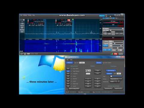

I did some progresses with my program and I want to show you the first significative result.
I rewrote the code of my previous remote cw keyer program transforming it in a remote control console for my next device. Now I have implemented the following features:
- 8 manual/automatic relay switch with embedded programming console (14 bands x 8 relays);
- rotator control console for Prosistel "D" (the only I had to test with);
- 2 hardware RS232 ports implementing 1.5 CAT protocol;
- remote cw keyer.
Here is the GUI I developed while it is running on the three most used operating systems (Windows 7, Mac OSX Yosemite, Linux Ubuntu 14.04-LTS).
About the cw keyer feature I am testing a sidetone generation system while SSDR is in remote mode. It is the first time I am using the java.sound APIs and I am wondering if I am on the right way or I can use a better library to do the job. There is a lot documentation on playing clips but far less about tone generation.
I had some clipping problems as you can see in the following video while I am working VP8STI DXpeditionhttps://www.youtube.com/watch?v=xYFYTc00xbg
Now let me thank Walt for his great advices! Mastering JavaFX isn't not so simple, but I am going on.
I hope the Flex Java APIs will be available as soon as possible.
73' Enzo

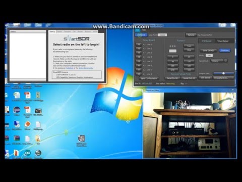

Hello,
in the end I have used the beads library (http://www.beadsproject.net/) that is most likely a wrapper for the native Java Sound Api I was using in my first attempt. With the beads library you have out of the box most commons wave generators, players of any kind and a very reliable enviroment for thread handling/synchronization.
Anyway tone generation is a matter of pc speed, audio sound card performance and cw speed. This actually means that you may experience bad delay if the mix of the three components is not enough for fast tone generation. I had good performance until 20wpm, but for more speed I still prefer the cw keyer sidetone generation. In this way I have a perfect timing until 35 wpm so I can consider this solution the only way to go.
At the moment my experiment is ended and I now I am able to control my little station from a remote place using a standalone device (no pc on the remote side) and do other things you can see in this video.
73'
Enzo
