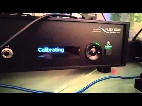

The 6300 doesn't have the display but on the 6500 there is a calibration sequence that takes some time. During this time the radio really hasn't "booted". Then once it gets through that it has to register itself with DHCP and depending upon your DHCP server it could take 10-30 seconds.

https://www.youtube.com/watch?v=Jr1WzSLAfpU
