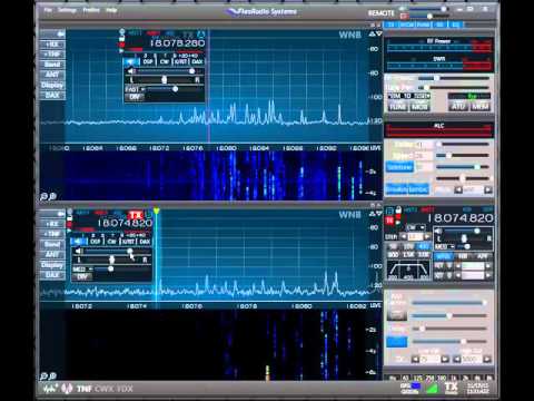

The bug:
The infocus area of the volumen round slider is smaller than the actual image of the slider in the screen. This happens in both the floating menu besides a slice and the Active slice menu on the side menus. This makes is very difficult to move the volume up and down (left and right) with the mouse pointer, because you can have the mouse on top of the knob but SmartSDR doesn't recognize it and doesn't set the focus of the mouse on the volume. It only happens with the slice volume and not the other sliders.
SmartSDR 1.5.1.152
Flex 6700 HW v. 1.5.1.70
Windows 7 64Bit SP1
See video below for a graphical description.
https://www.youtube.com/watch?v=X0qHbEnqR_g

3
I'll vote it up 1 for that "fix".1
I find this issue very common with many controls in SSDR.0

I tried on pretty much every knob, button and switch inside the SmartSDR window and the only one where I can see this issue is in the Slice Volume. Where are you finding this?0 -

On nearly every slider to some extent or another, particularly noticeable on the three slice audio controls on the right of the screen (I use these more than those attached to the carrier line). I even noticed that the active area has got slightly smaller with some of the recent releases. It was either from 1.3 > 1.4 or 1.4 > 1.5. A little OT:- I just hope the 'contest version' (aka 1.6) sorts out these interface inconsistencies/difficulties. My biggest bugbear is that the mouse scroll wheel does not operate the slider under it like in most windows programs...I am forever trying to operate the slider and find I have detunes my slice. Sri for the rant.0 -

I have always noticed that, especially when trying to "click-bump" a slider up or down one step at a time, i must be extremely precise as to mouse placement before it will "take" the command. Some sliders are more forgiving than others. Some require almost pixel-perfect placement.
For this reason, I have often dreamed of up/down entry boxes like we have on TX bandwidth settings rather than sliders for some functions that need more precision (Such as AGC-T, power, mike gain, Downward expansion, CW Speed, etc) If that were provided, I could also click in the value box and manually enter a precise number if needed.0 -
Ken, I find that many of the numerical boxes in SSDR will take text inputs, so if you want a non-standard frequency step, for example, one just has to enter it in the box in the normal way. Having to be so precise with my cursor for so many adjustments really grinds my gears. Maybe the expensive Maestro is the solution to this issue, hi hi. Seriously, this really needs addressing. Hopefully, if it drove/drives enough contesters nuts we could be in luck soon.

I just find this issue on the slice volume (AF) knob, it is the only one that is smaller than the rest in the UI. I think it can be fix in the code giving a larger area to the InFocus of the UI element.0
Salvador
I don't doubt what your saying. It's obvious in the video. I have trouble with this too.
However, I can't detect any difference in size, I just wiggle the mouse until the popup for the current value opens up which tells me that windows has noticed its that it's focused on the control, then click and drag. However increasing the size of the focus area a little would be useful. So would increasing the size of the trough on both sides of the slider knob, or changing the color of the troughs to something with more contrast. to make incrementing/decrementing by single mouse click easier.

I just tested that Sal and it works as I would expect. Now...having said that, look very closely at the control...in fact go full screen. The control for volume is a lighter shade of black than the surrounding area. It is a very subtle difference in shade. The height of the control is the diameter of the circle. If you type below or above the upper or below the lower 'latitude' of the circle you are not in the control. The boarder of the control is a different shade. The slider proper is inside the border. One of the other things I suspect the WPF slider does, as Java visual controls do, is they can be anchored to surrounding controls such that when the surrounding areas change size so do they. This, likely, explains the perceived different behavior of the last several releases or point releases. Remember WNB was added. Yes, it was added to a different 'tab' but the size of the drop down is likely tied to the inParentSize of the others. The would result in a slightly different sized slider with a slightly different slzed border.

I have entered this problem report into our bug tracker for additional investigation. Thank you for the defect report.
