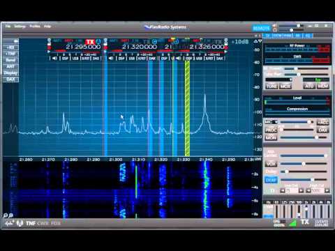

So I found this problem. Not a big issue but might want to put it in the bug tracker.
If you have an active TNF and you right click on it you get a pop up menu where you can select the depth of the TNF or if you want to remove, remember, etc.
If you move up away from that menu and the mouse pointer remains in the yellow area of the TNF and you left click on it, it disappears. If you do the same thing but the mouse pointer is outside of the yellow zone of the TNF and you left click then the behavior is the normal one, the TNF remains and the menu disappears.
If you have 2 TNFs and you right click on one and then move the mouse and left click on the other outside the popup menu the second TNF will close.
You can do this even if the TNF is on a different panadapter slice.
It's like the left click defaults to remove TNF when you move away from the TNF menu but stay in the yellow area of an active TNF. You get this behavior even if you have greyed out TNFs. As long as you left click on the TNF column.

Can you make a recording of this and post to youtube? What version of SSDR and Windows are you running? I have tried to duplicated from what I understand your describing and it seems to behave the way I expect not removing the TNF's.
Here is one free program you use to record screen sessions. There are others.
http://www.bbsoftware.co.uk/BBFlashBackExpress/Download.aspx
Ok I am able to able to recreate that using SSDR 1.5.1 Windows 10. What I was missing staying within the TNF yellow band to have the left or right click cause it to be deleted. That does seem like unexpected behavior though easily avoided by making sure not to click within the TNF yellow band. As you said probably could be added to the bug tracking. Or maybe that is a feature for quick delete ;-)
I have entered this problem report into our bug tracker for additional investigation. Thank you for the defect report.
