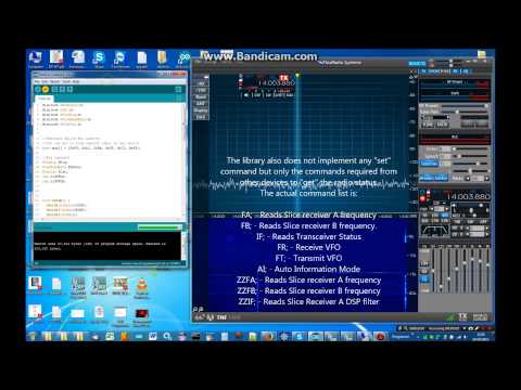

Below you can see the actual command list:
FA; - Reads Slice receiver A frequency
FB; - Reads Slice receiver B frequency.
IF; - Reads Transceiver Status
FR; - Receive VFO
FT; - Transmit VFO
AI; - Auto Information Mode
ZZFA; - Reads Slice receiver A frequency
ZZFB; - Reads Slice receiver B frequency
ZZIF; - Reads Slice Receiver A DSP filter

Last, I recorded a video to show you how you can use the software.
