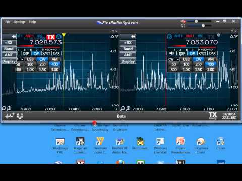

seems like i have seen a screen shot or two with 2 panadapters, side by side, instead of high and low. how is that done, please? 73, w5xz, dan

    Dan, I noticed it will switch if you adjust the window size. Here is a video with only 2 panadapters open. http://youtu.be/rLTOTDd5msE Probably other ways too, it seems to be automatic based on window size and number of pans open. Regards, Al / NN4ZZ

    hey, cool Al !! tt works! I notice i have to turn off the Tx panel...
  • W5XZ - dan
    W5XZ - dan Member ✭✭
    edited December 2016
    now, with two maxed out pans, i can see 1 to 28 Mhz !! kewl !!
