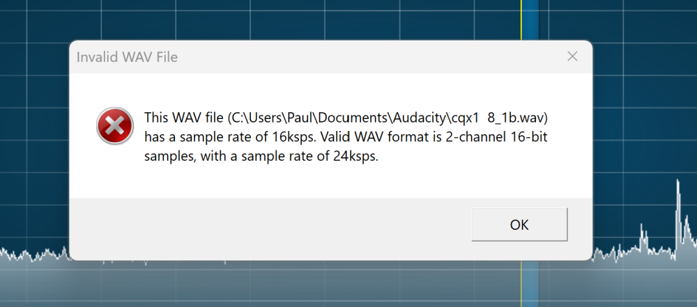

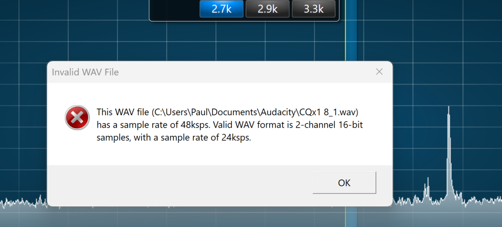

Running 8600 v4.2.20 on win 11 pc. I have used Audacity v3.7.8 to record messages that I want to use with SSDR DVK. When I try to import one of the recorded
.wav files, I get the first attached message. So I changed Audacity
settings to 22050 sample ( didn't see 24k available ) and 16bit format.
When I tried to import that .wav file, I got the second attached msg.
So I need some advice on what settings to make in Audacity — so SSDR DVR will accept them as an upload ??

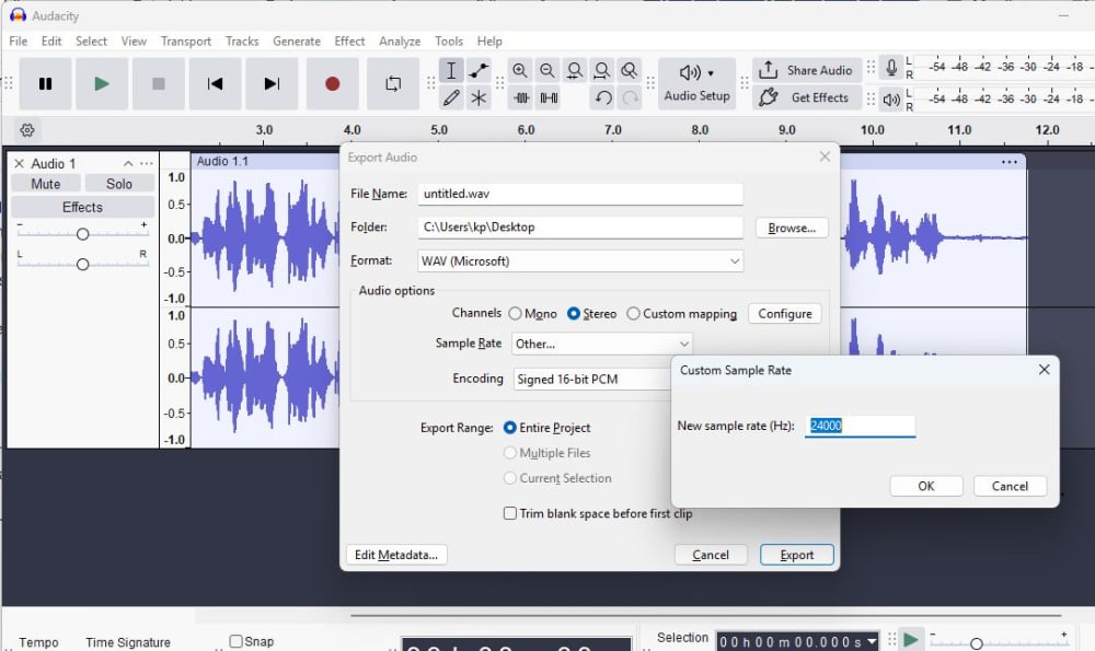

  • KlausP
    KlausP Member ✭✭✭
    Hi Paul,
    Give this a try.
    73 Klaus
