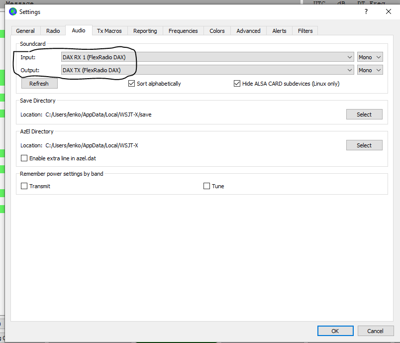

I updated to the new version and can't get WSJT-X audio to work, no decode no power output when tune enabled. It reads, changes frequency just won't decode. If I degrade to 4.1.3 it works. What do I need to change?
Thanks Len, that fixed it. I looked at the audio settings and they were "right" (still the same as before). I didn't know/realize the names had changed.
